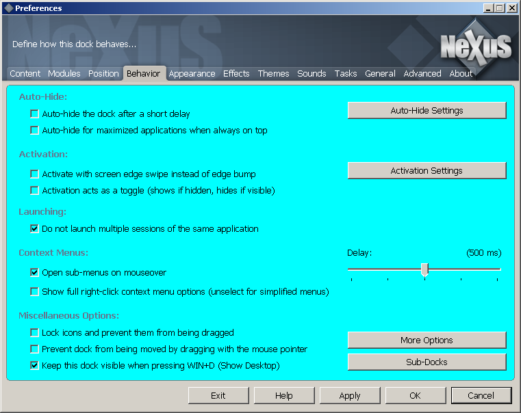

Can you please post a screenshot of the Dock Item Properties dialog for that PowerShell item in your dock?
Also, since this might have an influence as well, in the Behavior tab for that dock, is 'Do not launch multiple sessions of the same application' enabled?

Yes, it is via a shortcut. I don't know any other way to change colour ect. on the prompt.
I tried to uncheck "Do not launch multiple sessions of the same application"
and it makes no diff.
Here are some screenshots, and beware, one of them is in Danish:
