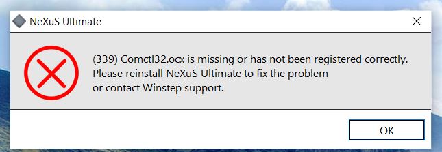

It's back! :) See screenshot of error msg.
I get it when I try to open Prferences. The screen opens after I click on OK.
Selecting most of the tabs in Preferences, and again when I select General or About. Dock Properties window opened, but I get the same popup error msg. when I click on Position, Behavior and Effects, the first time.
The second time I clicked on the tabs they all opened okay. And then Preferences opened without the error message; it opened to About, and see my registration, which I didn't see the first time (as described above.)
So it's still sporadic.
Before I found the recent backup file, I had updated the dock shortcuts which needed updating. So I changed my mind about using the backup file, which I'd also have to update. 8)
Kami

This issue has nothing to do with temporarily losing your registration.
Try doing what the dialog suggests: re-installing the FULL version of Nexus Ultimate *on top* of your current installation (i.e.; do NOT uninstall anything first). Don't forget to exit Nexus Ultimate prior to running the installer.
Once that's done and Nexus Ultimate is running again go to Preferences and see if you still get that error message. If you still do (and only if!) this is something that can happen if some rogue application installs another version of the comctl32 into System32 instead of SysWow64 on a 64 bit system. In that case:
1. Exit Nexus Ultimate.
2. Search the C:\Windows folder for Comctl32.ocx - my guess is that you will find it in two different locations.
3. Rename all copies of comctl32.ocx to comctl32.ocx.bak.
4. Re-install Nexus Ultimate on top of your current installation again.
