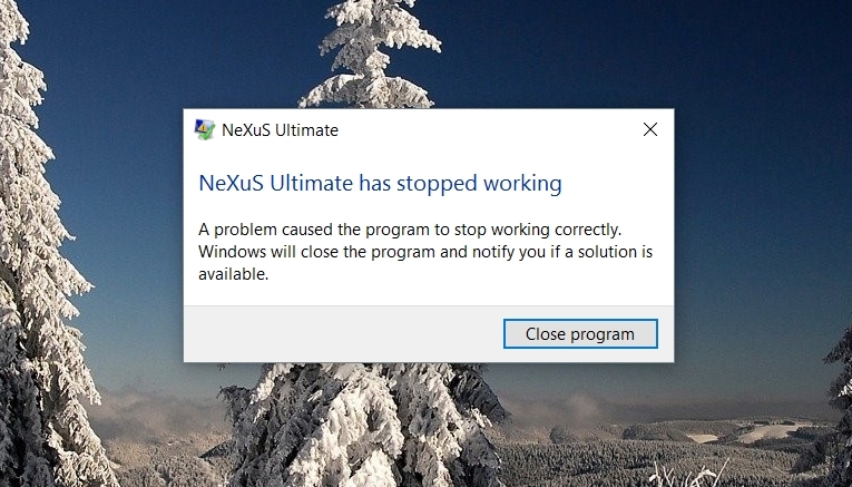

I wanted to attach the message that accompanies Nexus Ultimate crash as it exist on my laptop.
This is what I've learned about this behavior.
It happens on my HP Envy laptop, sporting Windows 10 Evaluation copy: 14379. It occurs if I plug in my electrical cord, a printer, or an external disk drive - every time. It is a hard crash; I cannot reload Nexus unless I reboot my system. When I try and reload the program, I see it in my task manager's list, but the dock never appears on my desktop; I have to reboot the system in order for the program to work as it should.
Of course, this is an evaluation copy (OS) I'm writing about here. I've opted to wait for any other updates until the final version is released on August 02, 2016. Hopefully, whatever is causing the crashes, will be fixed in that build.
I thought I would share my experience with this crash as I've experienced it here.

Thanks for the screenshot. That dialog doesn't tell me anything useful, but something else you said does: that it occurs 'every time'. This goes against what you said previously. :)
