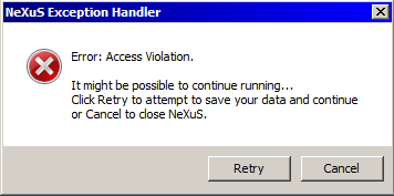

I've done multiple startups today and it happens every time. Nexus pops up an exception violation box (see attachment) and NextStart crashes with the following report:

I don't see how I could have the free version of Nexus since everything came in one install file. So I reinstalled Xtreme using the following steps:
