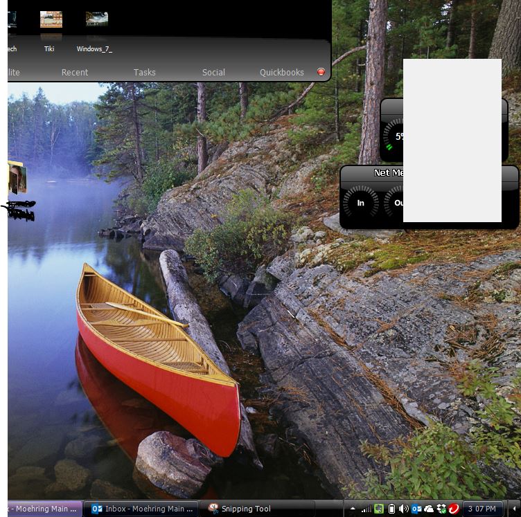

Having problem with a white box appearing on my desktop that stays on top of all open windows. Location at which it appears to be random, but once on the only way to get rid of it is to close workshelf. I have included a screenshot

You know what, that looks like a GDI+ invisible control window. Only it's visible in your case.
Are you using any type of Virtual Desktops software?
Also, open NextSTART Preferences, go to the Hotspots tab, select New, change 'Hotspot Button on the Desktop' to 'Left clicking on hotspot', click Next, click Next, click Next, drag the little magnifying glass icon over the blank window. Does it give it a name? If so, what is it (don't forget to Cancel the creation of the new hotspot after this)?

The name of the white spot is NxDock
I do not believe I am running any virtual windows. Also I have updated to Windows 10 and still get the spot on occasion. The only thing I am running now is the Workshelf. The pop-up only occurs when subshelf drops down, and not always.

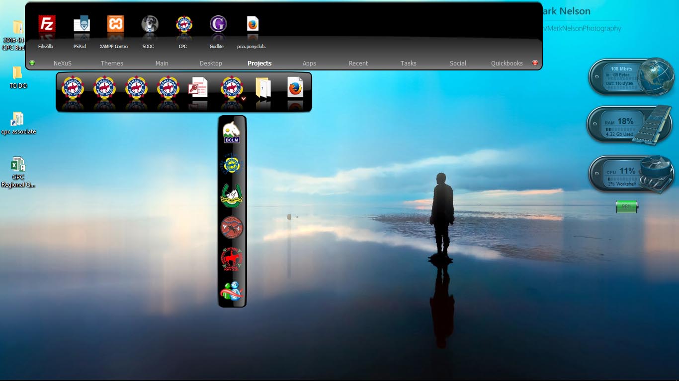

As you can see by the image below. I have a main category called Projects, in which I have m projects listed. In each project I have links to different urls' documents I use. In the third dropdown is are links to url's that use the same software.
I really like that workshelf does this, as I use it quite abit. Is there a better way to do this that I haven't thought of.
I can delete the subdock and see if the problems still persists?
Let me know what you think
No, no, let it be, better if we find out what is causing it so I can fix it. :)
Now that you know the *probable* culprit, try to pay attention to what you were doing just before that white box appeared, to see if it was related to the sub-docks in the Shelf and if we can find a way to reliably reproduce the problem here.
For instance, it could happen only when the Shelf collapses while a sub-dock is still open, etc...
