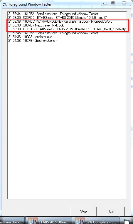

I have uploaded a screenshot of foreground tester which shows the issue. "MS Word" was on focus and I wanted the switch to "ETABS". After left click, ETABS gets the focus for a very short time and suddenly Word gets the focus again. I didn't clicked on Nexus.
Weird thing is, foretester does not show Word's "second focus".

Perhaps because the window was not really the active window. When you say 'got focus' what really happened? What did you see?
Anyway, what worries me is Nexus showing up between Word and ETABS. Did you switch to ETABS via Nexus or via the Windows taskbar?
