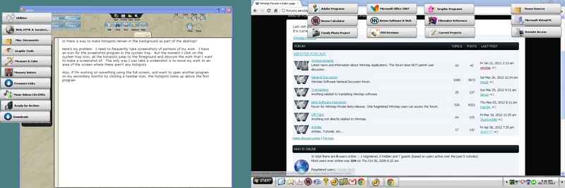

Here's my problem: I need to frequently take screenshots of portions of my work. I have an icon for the screenshot program in the system tray. But the moment I click on the system tray icon, all the hotspots jump to the foreground and obscure the work that I want to make a screenshot of. The only way I can take a screenshot is to move my work to an area of the screen where there aren't any hotspots.
Also, if I'm working on something in full screen mode on my primary monitor, and want to open another program on my secondary monitor by clicking a taskbar icon, the hotspots come up above the first program. I have to then click on the first program to bring it to the front, then I can return to the second program to work in it.
I've attached a screenshot that shows a program open on each of my monitors. Hotspots on each monitor popped to the front when I clicked on the screenshot icon in the system tray.
Seems that the hotspots should remain in the background unless they are specifically called on to perform a task. Any suggestions?

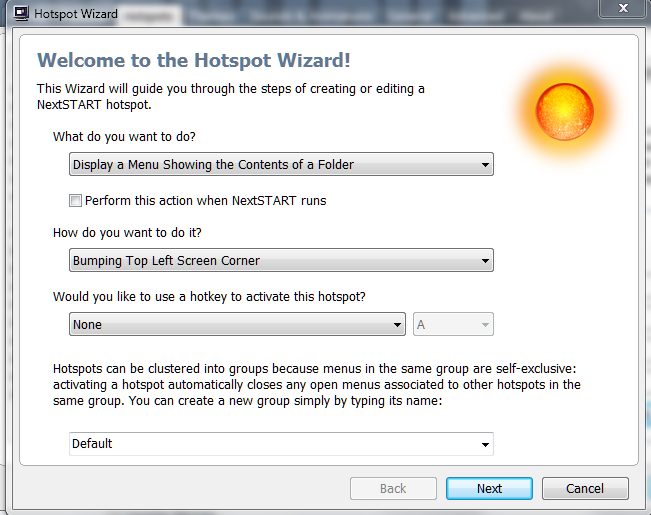

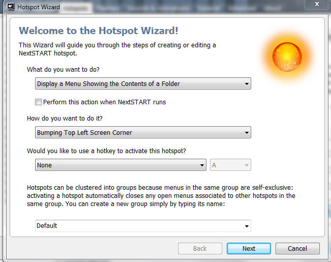

What command do you have set to open these folders/functions? Here is a screenshot of a setting for one of my Hotspot folders which is accessed by opening NextSTART-> Hotspots-> click on folder in list on the left side-> Edit. Of course continue until the process ends.
If you are not editing a name in the list, click New once the Hotspot tab is opened and set it up from there. YOU MUST BE CAREFUL THAT YOU ARE NOT DUPLICATING A FUNCTION. THIS COULD BE THE REASON YOU ARE HAVING A PROBLEM. Carefully check each one to make sure that this isn't the case.
For example with the screenshot I provided, I can't assign another folder/function with Bumping Top Left Screen Corner and expect it to work. Obviously this will cause a conflict.

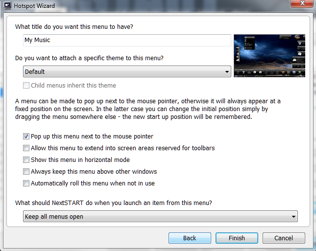

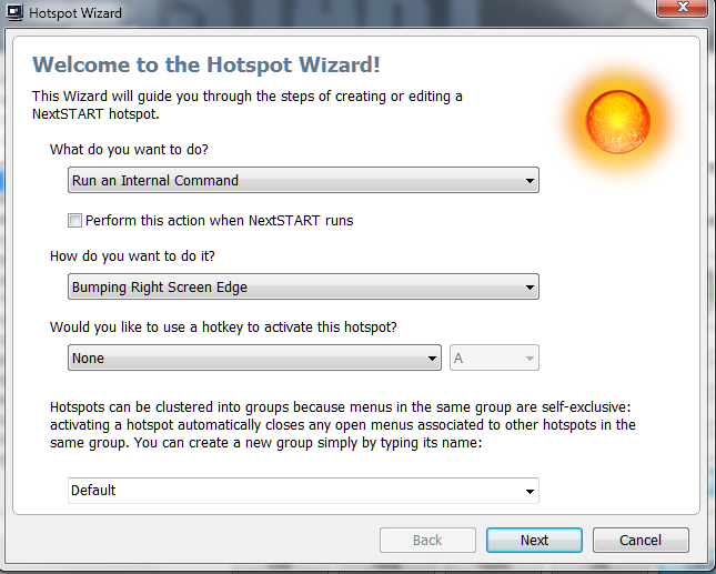

Here is a screenshot of my 4th screen. "Keep all menus open" is a handy feature that allows the Context Menu to stay open if you have more folders and/or files than can fit vertically on the screen. It keeps an indefinite amount open side by side which enables you to move freely back and forth without it closing. Just put the cursor on More at the bottom to open the next row. There are more settings that you can choose to close the Context Menu and other features.

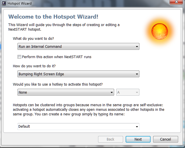

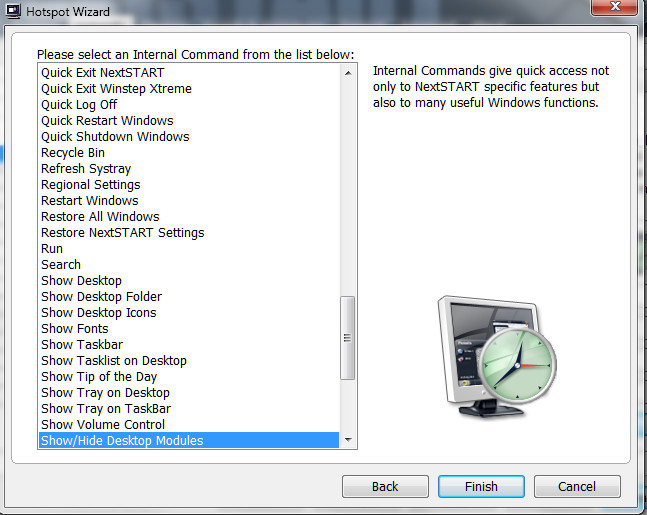

The next screenshot is for Desktop Modules. I'm not sure but maybe you can try that setting which is Run an Internal Command in the first window on the 2nd screen.

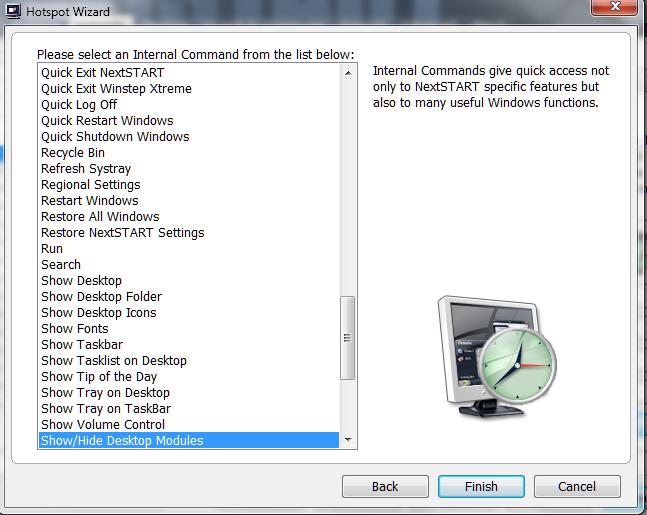

The next screenshot shows the setting on the 3rd screen that I have for Desktop Modules. You might find a setting in that list that will work out for you.
