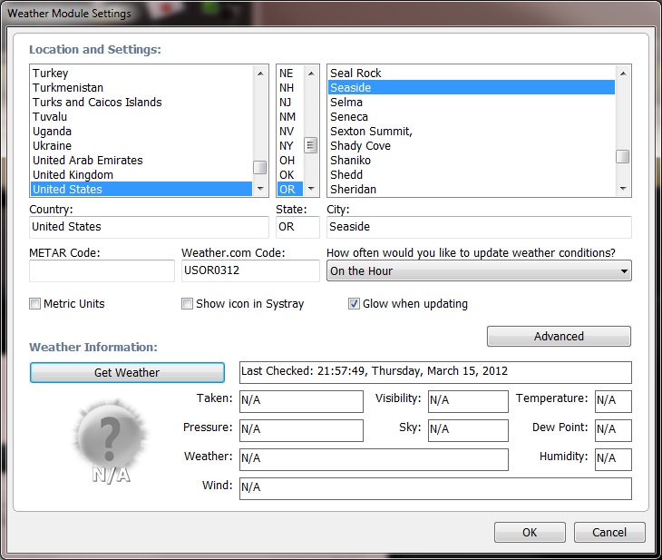

I'm trying out Nexus for the first time tonight, and I went in to change the weather module to my city, but when I click Get Weather, it gives me an error. The error is "Unknown / Invalid location". I picked my city from the list that is at the top of the settings window. Other cities around my area work fine.
I may have figured out the problem. I put my State for the country and that fixed it, so I believe the problem is that there's more than one town in the US by my towns name.
Also, now I'm only getting a 4 day forecast. I checked http://weather.msn.com/RSS.aspx?wealocations=wc:USOR0312 and I get a blank page. Does that mean MSN weather doesn't have my city right now, or did I make an error in the URL?
File comment: My settings, just in case.

What version of Nexus are you running?
In v11.10 the possible weather sources are METAR (info provided by NOOA based on a METAR code, current weather conditions only), MSN Weather and Google.
MSN Weather is a bit unreliable and I've noticed that it sometimes returns a blank page for particular locations. When that happens, the widget falls back to the Google weather feed, which unfortunately only provides a 4 day forecast instead of 5 day forecast.
My advice is that you download the beta of v12.2 from this thread HERE, then report back. v12.2 also restores the old Weather.com feed.

I was using 11.10, and when I try the beta, the weather module works fine. Thanks for your help. :D

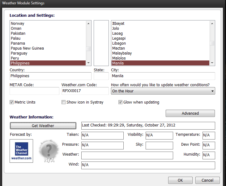

I can't get weather information from Manila, Philippines.. The METAR code is missing.
File comment: SCREENSHOT

Hi SuperRocket03, try this: RPLL
It took quite a bit of research. I tested it and it worked for me so it should work for you. Let me know if it works.

I just tried that location and it's working fine for me. Maybe Weather.com data was temporarily down for that location? Otherwise, try other locations - if none of them work, then the problem is your firewall blocking Internet connections for that Winstep application.

It must have been temporarily down because it wasn't working when I checked it. I did notice in my research that the METAR code was not in the side by side listing with the weather.com codes. There were a lot of locations like that.
I found the METAR code in a totally separate site from the listing where both the weather.com and METAR codes are listed side by side. I guess I finally found the correct query that pulled up the site that displayed only that location's METAR code.
SuperRocket03 should be up and running now. If not, then as you said Jorge, it's on his end. Well, not if it goes down again. :lol:

I checked the Weather Module Settings and the METAR Code was there.... Thanks :D
