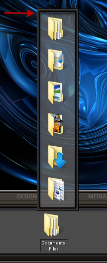

I have a question on in-shelf subdocks:
In image 1 the top of the subdock has a blue highlight and an inner shadow which is at the top as so:

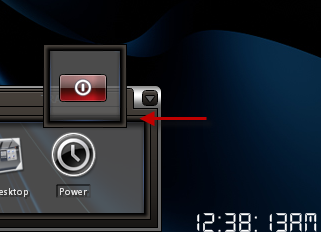

I also have another in-shelf dock, but the dock image is flipped vertically and now the highlight and shadow are on the bottom like so:
Why is that, and is it suppose to be that way?

Docks (even floating docks) have four possible orientations, based on their on-screen position: vertical left, vertical right, horizontal top, horizontal bottom. Background bitmaps are automatically flipped and mirrored as necessary.
So my guess is that one of the sub-docks appears on the left half of the screen and the other on the right half.

AAh,did not know that thanks Jorge! I put my second sub-dock on the same side as the first one...
