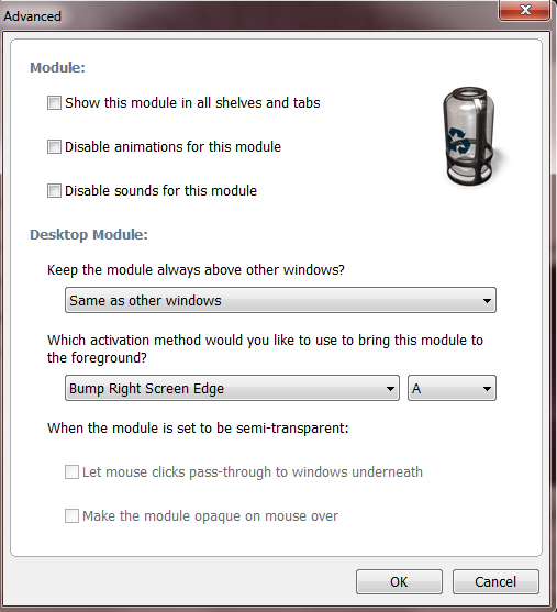

Open WorkShelf Preferences, go to the Modules tab. Now select the Recycler module. Click the Advanced button. In the dialog box that pops up, what does it say under 'Keep the module always above other windows'?
 Post subject: Re: Recycle Bin Module Bump
PostPosted: Wed Apr 13, 2011 7:38 pm
I just noticed the pull-down area I have circled in red has another option that says Recycler which matches what's above it. Does this have a bearing on anything?
As you can see, I have it set to Same as other windows.

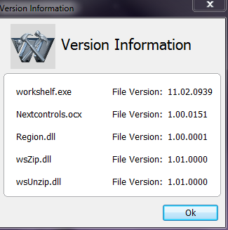

The hard drive on my laptop was failing hence the reason I had to do a System Recovery every few months for the past year or so. It finally died and I was without one for several weeks.
I was finally able to get a new Windows 7 PC and have been reinstalling for the past couple of days. Unfortunately, I'm still having the same issue. I left the setting to None and it didn't help. Jorge, you stated that you're using Version 11.5 and it works fine. This is the version that is currently installed and the prompt states that it is fully updated. I'm stumped.

There's a Beta Discussion Forum section on this forum, in case you didn't notice. :wink:
You're not seeing v11.5 on the Winstep Update Manager because it's still a private beta currently available to register Winstep users only, and hasn't been officially release yet. To be able to try out the new goodies in private betas before everyone else, you must be a registered Winstep user (which you are) *and* apply for access to the Beta Discussion section of the forums (which you didn't).
