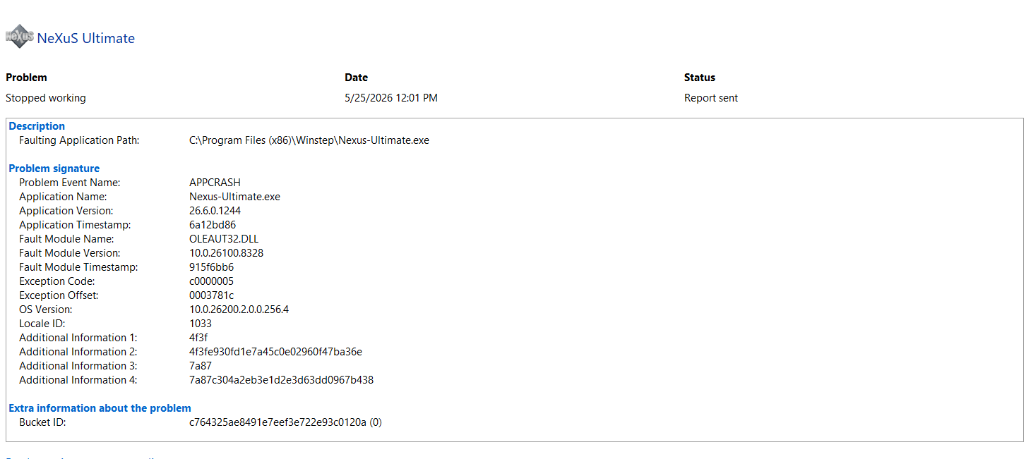

I’m using Nexus Ultimate version 26.6. This morning I updated to the latest beta version, and since the update the app keeps crashing. My system is running Windows 11 Enterprise 25H2. Has anyone else seen this issue or found a fix? Any guidance would be appreciated.
Please see the attached crash report.

Unfortunately all that crash report tells me was that there was an access violation in OLEAUT32.DLL, but it does not tell me why.
Unless I can reproduce the issue here - and so far I have been unable to - I will need your help to try and figure out what might be causing this on your system.
