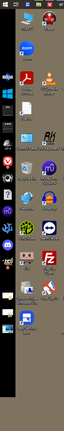

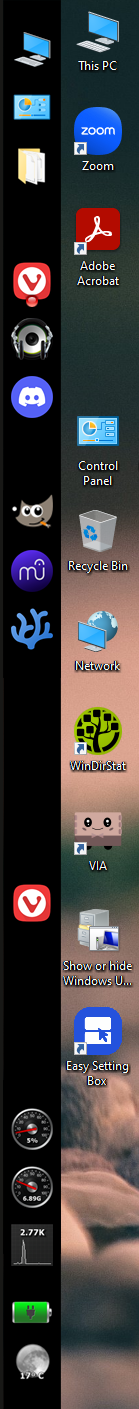

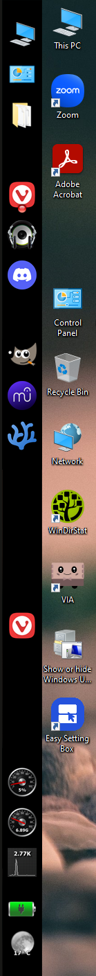

I have been using the Nexus dock for quite a few years now. For the longest time, I had the dock looking like a Mac replica: docked to the bottom of the screen, centered, 3D-looking.
However, in recent time, I have started to take a liking (influenced by my work PC, which is running Ubuntu) to the Gnome-style dock, which is docked to the left of the screen, stretching vertically along the whole edge, 2D-looking, opaque black background. Thus I tried to replicate the look in WinStep Nexus. However, I'm running into trouble because I can't get the dock to fill up the left screen edge (i.e. extend from one edge to the other).
My idea was to create a new theme that has a background image (possibly a 1-px png image) that either repeats or stretches to a very large size, covering the whole edge. However, I haven't been able to create a background.ini configuration that actually works, so I'm asking for help on how to achieve that, or if there is any configuration that might help.
I have moved the dock to the left edge of the screen, and positioned it to top (offset 0%). My current background.ini file looks like this:
Code:
[Background]
LeftMargin   = -200
RightMargin  = -200
Outside-LeftMargin   = 200
Outside-RightMargin  = 200
The resulting dock appearance is shown in the attached screenshot.
This kind of works, but it has a problem. The dock expands in size, as elements keep being added or removed from it, either by adding launchers, or by starting new applications. This makes the size unpredictable, so I cannot configure it properly in the background.ini, unless there is some sort of a property that I do not know of. I probably need to configure a fixed buffer area that shrinks dynamically.
Any ideas?
File comment: Dock appearance

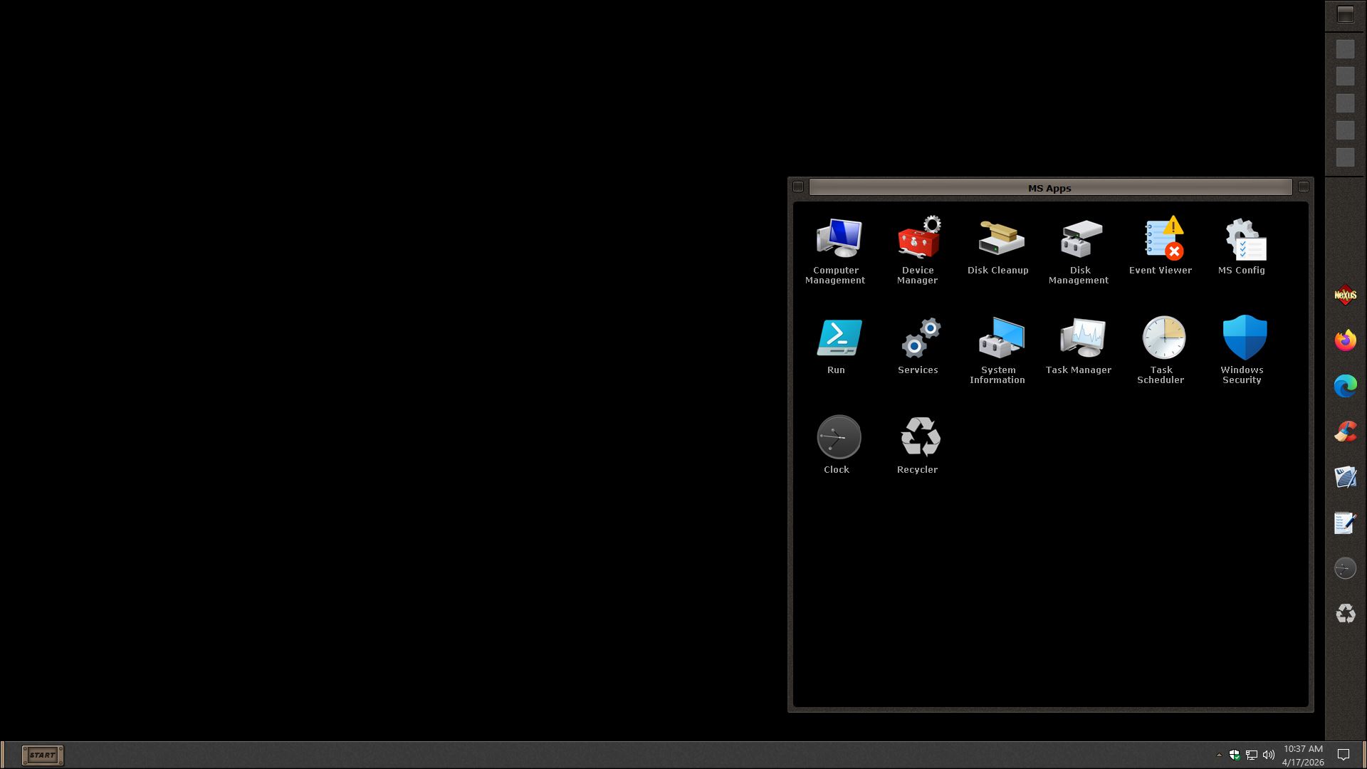

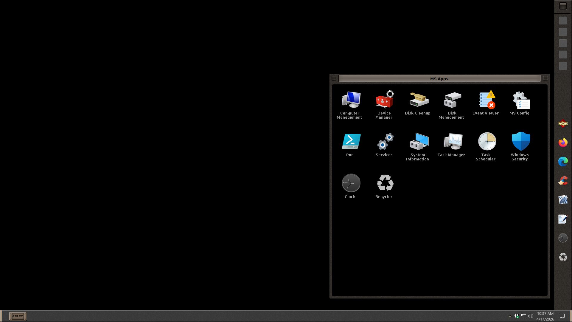

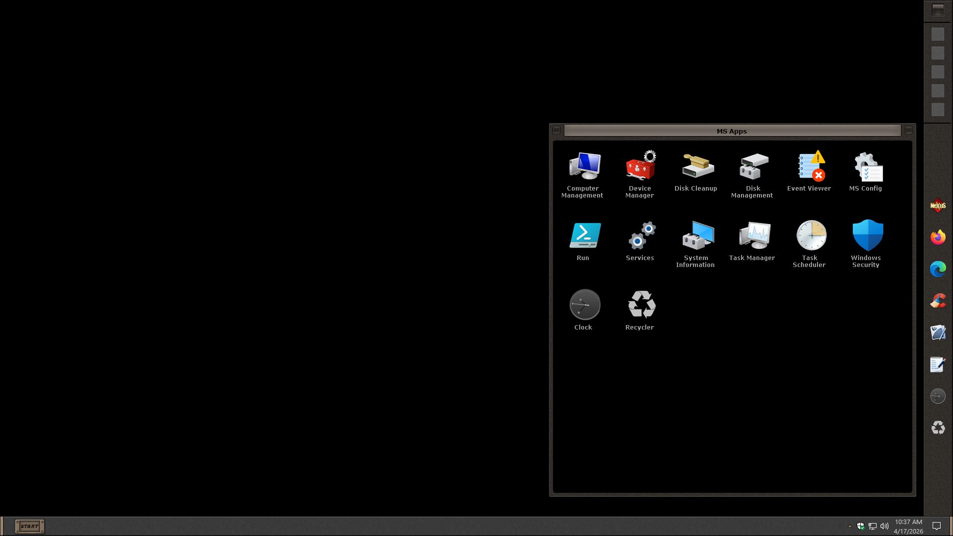

I have tried both options given and they work just fine. After much experimenting I discovered a third solution. Make sure to backup your setting before trying this. It is hard to remember what you have changed.
I have the NextSTART taskbar on the right and the Windows taskbar on the bottom. The NextSTART taskbar has several Grid Stacks on the top (the grey square icons) (the image shows the "MS Apps" Grid Stack open) and a Dock positioned on top of the NextStart taskbar. The dock is set to appear "Always above other windows". The NextStart taskbar is set for "Full screen width", "Dock to screen edge", and "Prevent maximized windows from overlapping the taskbar". I also set the Quick Launch area to "use up to 100% of the taskbar".
For the NextStart taskbar I checked both "Allow NextStart to replace the Windows taskbar" and "Keep the Windows taskbar visible". It should also be set for "Windows 7 style". The Grid Stack icons are in the Quick Launch area and the icon size is set to 34. The Dock icon size is also set to 34. Use the Dock position settings to center the Dock on the NextSTART taskbar.
You have to check the boxes to "Hide the tasklist" and "Hide the system tray". You also have to uncheck "System Tray" under "Taskbar Sections".
To add a Grid Stack to the Quick Launch area first create a Grid Stack on a dock, and then under "Dock and Shelf Management" chose "Disable Dock". You can then add the Grid Stack as a new Quick Launch item.
If a game or application has a Full Screen setting it must be checked or both the Windows and NextSTART taskbar may appear above the game or application.
I haven't used this setup for a while. I believe there was one other minor glitch that I came across, but I don't remember what it was.
I am using the Winstep Lapidi theme (with colors modified) and the WindowBlinds Hinged theme in the image. There is also a WindowBlinds Lapidi theme that matches the Winstep Lapidi theme, they look great together, but I prefer the Hinged theme.
I think that is everything.

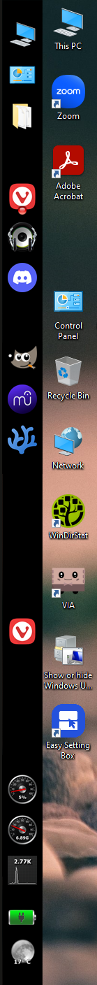

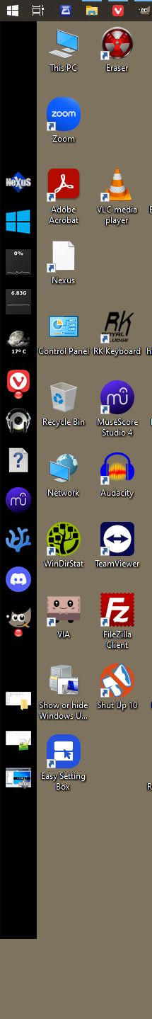

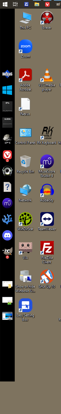

Since the thread got so lively and there were quite a few replies, I guess I owe everybody one from my side.
First, I'm not going to pretend I know the difference between different UI elements. I guess you're right, Jorge, when you say that a dock is not supposed to behave like a taskbar. I guess I want a toolbar, or a sidebar, something that docks to the left side of the screen, and has some icons and applets in it. I now understand that Nexus is not supposed to be able to do this, since it's different in nature to the Ubuntu sidebar that I'm trying to mimic. Nevertheless, thanks for the understanding, and thanks for implementing the "stretch" feature in the application (I just read the message).
@nexter: I'm not a big fan of Ubuntu tbh, neither of Gnome (I don't dislike them, I simply don't feel either way about them). However, I think the idea of having a vertical toolbar that occupies space permanently is actually quite smart, given that most monitors (at least those that I use) are at least 16:9 and have much more horizontal real estate than vertical. But I still like the way the Mac dock (including the original Nexus look) looks and feels.
I did try to play around with shelves, a little, to see if I can get one to do what I want it to do. However, I opened the configuration file(s) for one of the skins and I was overwhelmed with the amount of options, so I simply gave up.
In the end, I did manage to create some kind of a Frankenstein combination of 3 overlapping docks, one using a heavily padded skin (both left and right) and the others not so much. The top dock has some launchers, the middle one contains only running apps, and the bottom dock contains some applets. The middle one overlaps the other 2 and is the only one that actually changes in size.
It looks quite nice TBH, but I suppose that there is room for improvement (I doubt that my creation is very tolerant to resolution changes), but this is the first iteration, the next one will be better, I guess. Screenshot attached.
Have a nice (rest-of-the) weekend!
