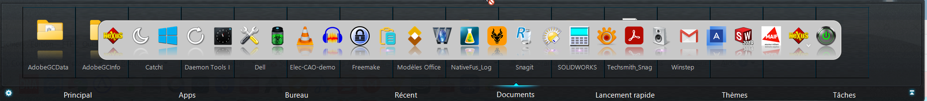

Hello to the members of this forum,
I just bought a Winstep Nexus Ultimate and recently joined this forum.
Here's my problem:
In my setup, the tablet and a bar are overlapping the top edge of the screen. How can I drag a shortcut into the bar? Currently, the tablet doesn't allow it.
Has anyone else encountered this problem?
Thanks in advance.
JCSK

Can you please post a screenshot? The French to English translation doesn't make it very clear what is happening there... :D

I think he has a shelf docked to the same edge as a dock (in which case the answer is he shouldn't, but can pull it off using the dock's "offset from edge" setting), but I want to make sure it's that.
He's French and machine translations can make a mess of terms like "shelf" and "dock". He also just started using the application, so give him some slack. :D
File comment: Bonjour à Jorge et Nexter,
Merci à tous les deux pour votre réactivité.
Merci également à Jorge pour sa compréhension du fait que je suis tout nouveau au regard du forum et du logiciel.
Je me permets de vous répondre en français. Vos traducteurs sont certainement plus performants que les miens.
Si j'ai bien compris, on se tutoie sur ce forum. Alors allons-y !
Vous comprendrez aisément tous les deux que je ne peux pas glisser une icône (raccourci) dans la barre des tâches (dock) lorsque la tablette et la barre se superposent.
Vous trouverez une copie d'écran de cette situation.
Très belle journée à tous les deux.
JCSK
Oh I'm happy enough to cut him some slack - it's the imbecilic AI translation I was gunning for. ;) And I'm well aware of how problematic French to English machine translations can be, though the worst is the other way round. That can actually result in some mind-boggling insults! :lol:
Admittedly though, the mind now has to boggle over that screenshot. Holy smoke, what a mess! Unbelievable amount of icons. :|

JCSK,
What you are trying to do is basically the same as making two bodies occupy the same physical space - in Sci-fi movies that only results in a huge explosion and both bodies being completely annihilated. :D
With a shelf and a dock what happens is that one ends up obscuring the other. There are only two solutions for this: you either dock one of them to a different edge (for instance, here I have a shelf at the bottom of the screen sitting right above the taskbar, and the dock at the top) OR in the Dock Properties tab you offset the dock from the screen edge in such a way that it does not cover a fully expanded shelf.
But the bottom line is that you should not have a dock and a shelf docked to the same screen edge.

Bonjour Nexter,
Merci pour votre réponse.
Ok, c'est clair, pas de superposition d'une tablette et d'une barre de tâches.
Il semblerait qu'il y ait des problèmes de traduction. Dans Winstep Nexus Ultimate la barre principale s'intitule "Tablette" et la barre des tâches s'appelle "Barre".
Très belle journée à tous les deux et cordiales salutations.
JCSK
