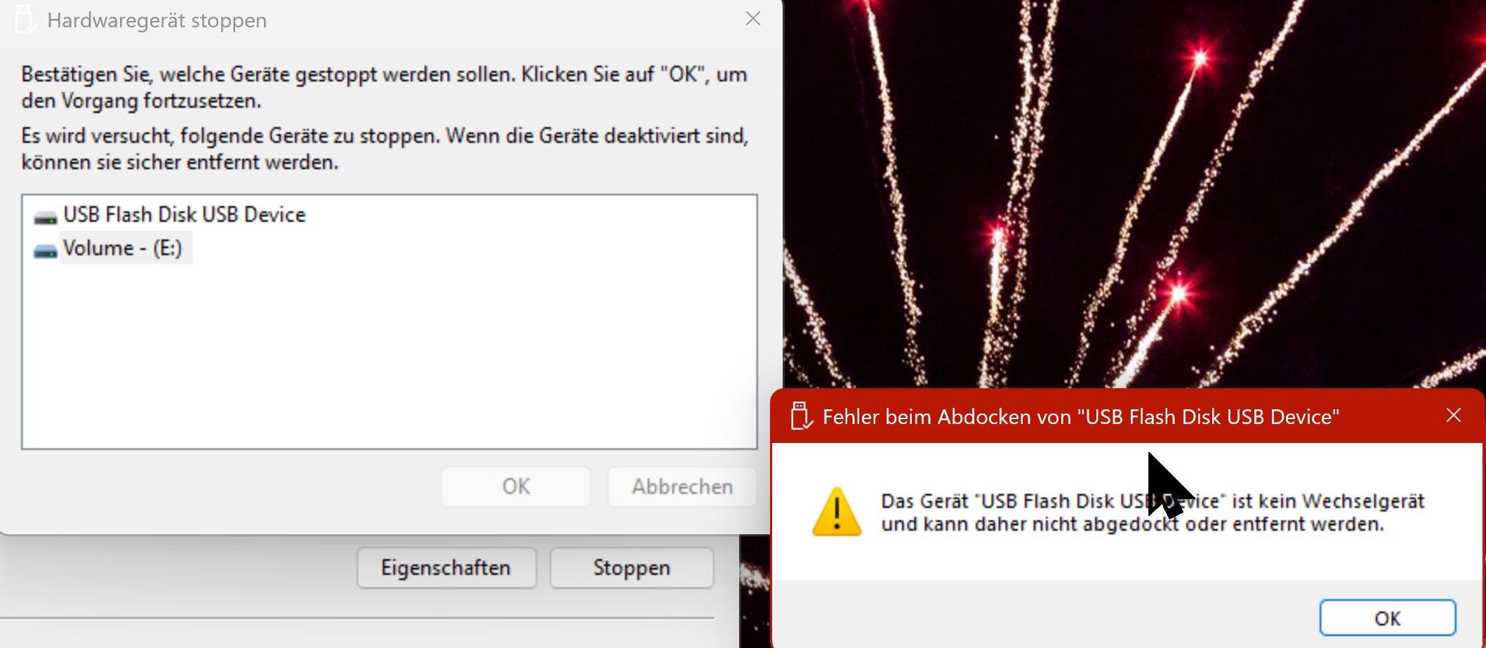

Hello Jorge
the problem with your internal command is, that it does not work.
At least it does not work at my windows 11 PC. I get an error message, that my USB stick is not a removable device and I can not eject it.
But the script I use is working for me.
Details, Andreas, details! :D
That dialog belongs to Windows. If it doesn't work, I blame Microsoft - as usual. :D

Andreas_HGW wrote:
Sorry to say this, but if my script works fine, the problem is with your internal script.
Ah, says he who knows not the true insides of things. My "script", if you can even call it that, simply calls that particular *Windows* dialog.
You can evoke that yourself via the Windows Run prompt (WIN+R): rundll32.exe shell32.dll,Control_RunDLL hotplug.dll
Actual "ejection" (or rather, the apparent lack of it) is performed by Microsoft's own code in hotplug.dll, which was written by them and not by me.
So I double down on blaming Microsoft. :D
