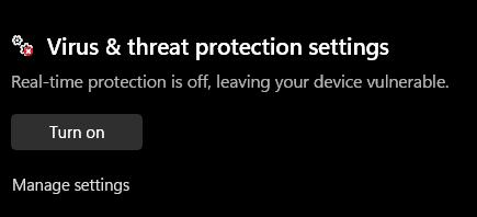

I tried both methods and even went a step further. I turned off all virus and threat protection settings as well as added the app to the "safe" list. I even turned off all virus protection as well as turned off all firewalls. All with the same result.
I have tried to install as an admin and as a regular user. Nada, nothing....
What else? Anything?

Plot thickens, I really am as clueless as you are at this point :shock:
Check the Windows Event Viewer after trying to run Setup, both the System and Application Windows logs. See any related error entry?
Also, you're not running an Insider (beta) version of Windows 11, right?
If you right click the UltimateSetup.exe file and select Properties, what size is it in bytes?
