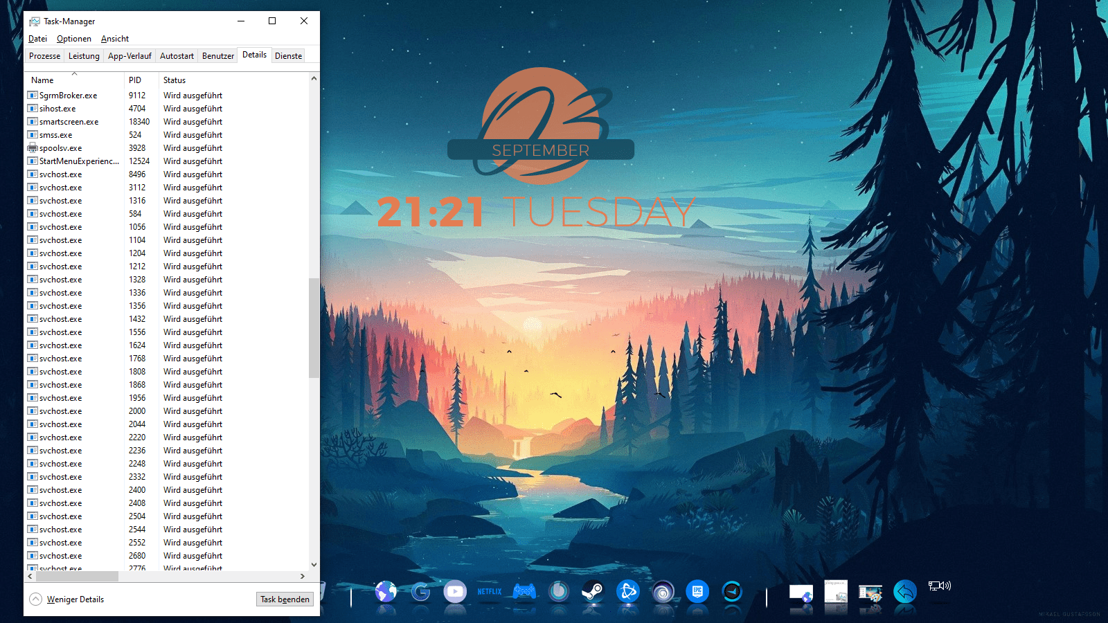

-StronK- wrote:
For the apps Steam and Battlenet it appears that the apps are running, but they are definetly not. It shows like that even when I fresh re-/started my pc. Nothing appears in the task manager.
Are you sure? Now go into the Details tab of Task Manager instead of the Processes tab and look for the respective executables. Pretty sure you will find that they are still running in the background.

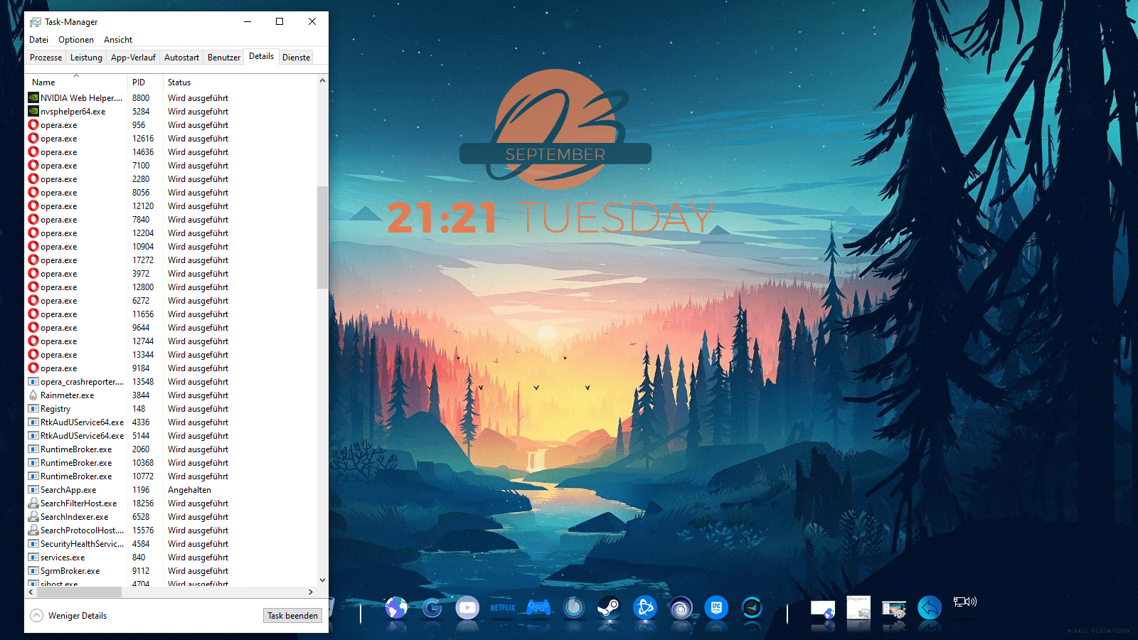

Hey, thanks for you answer.
I already checked this, because I read this tip in another thread.
Please, look on your own:

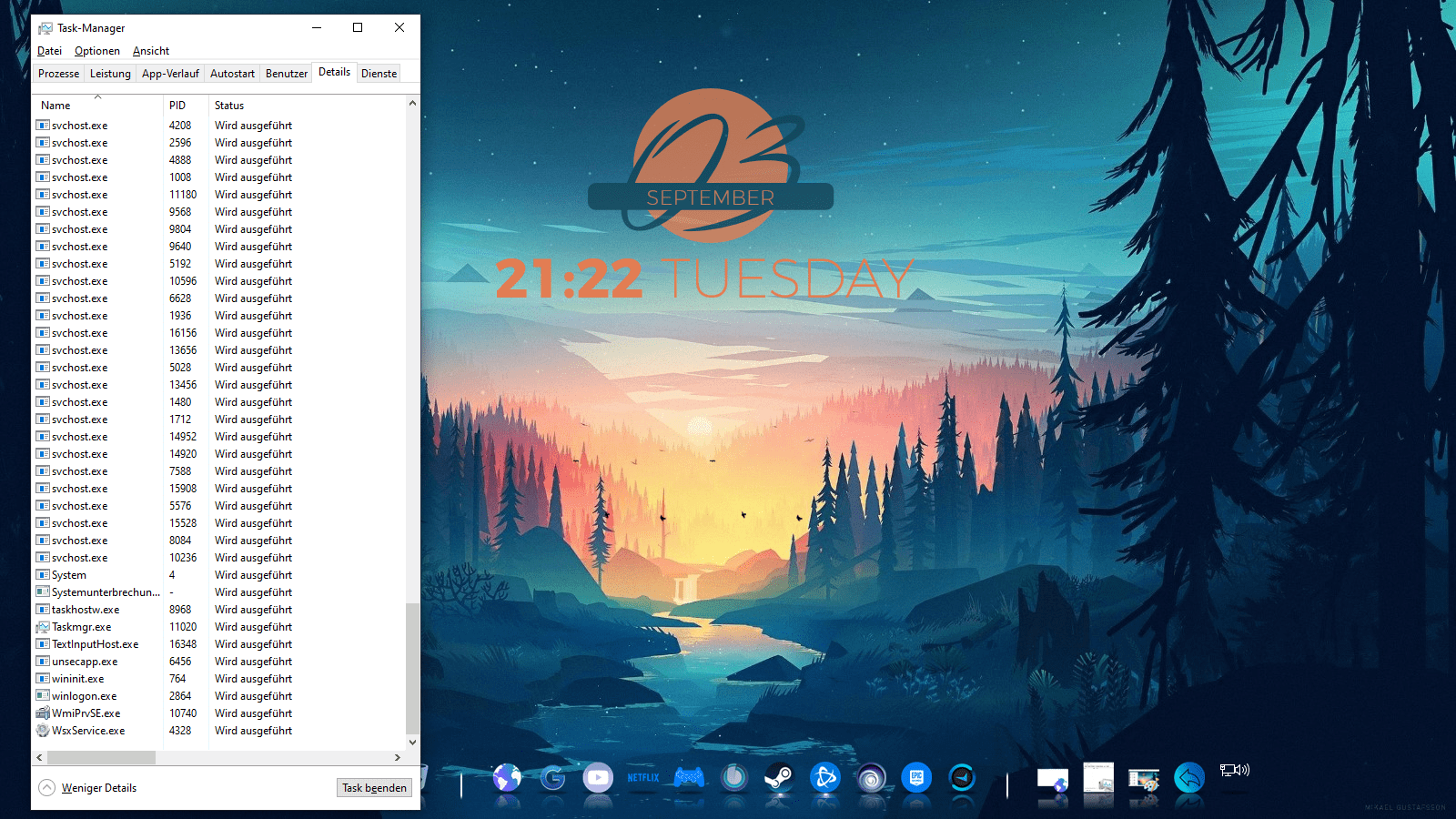

Last Screenshot:
It is not only when I exit Steam/Battlenet, it also shows like that when I do a fresh start of my PC.
Autostart is deactivated. And the problem occurs only for a few days now, the years before everything was fine... hmm...

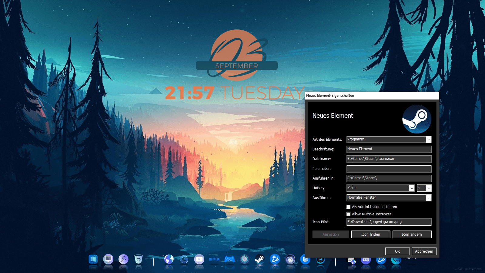

 Post subject: Re: Running Indicator shows apps are running but they are no
PostPosted: Tue Sep 03, 2024 7:46 pm
Posts: 13047
Thanks for the screenshots. A few more questions:
1. Can you please post a screenshot of the Dock Entry Properties dialog for the Steam shortcut on the dock?

1: I am not sure what you are talking about, my english is not the very best. Do you mean this?

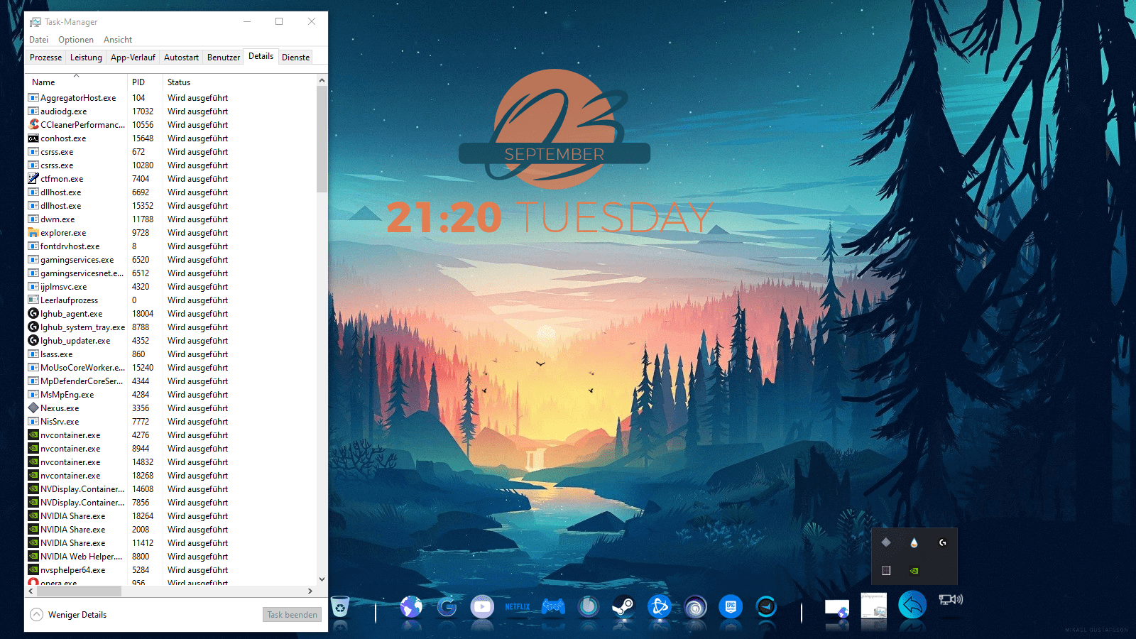

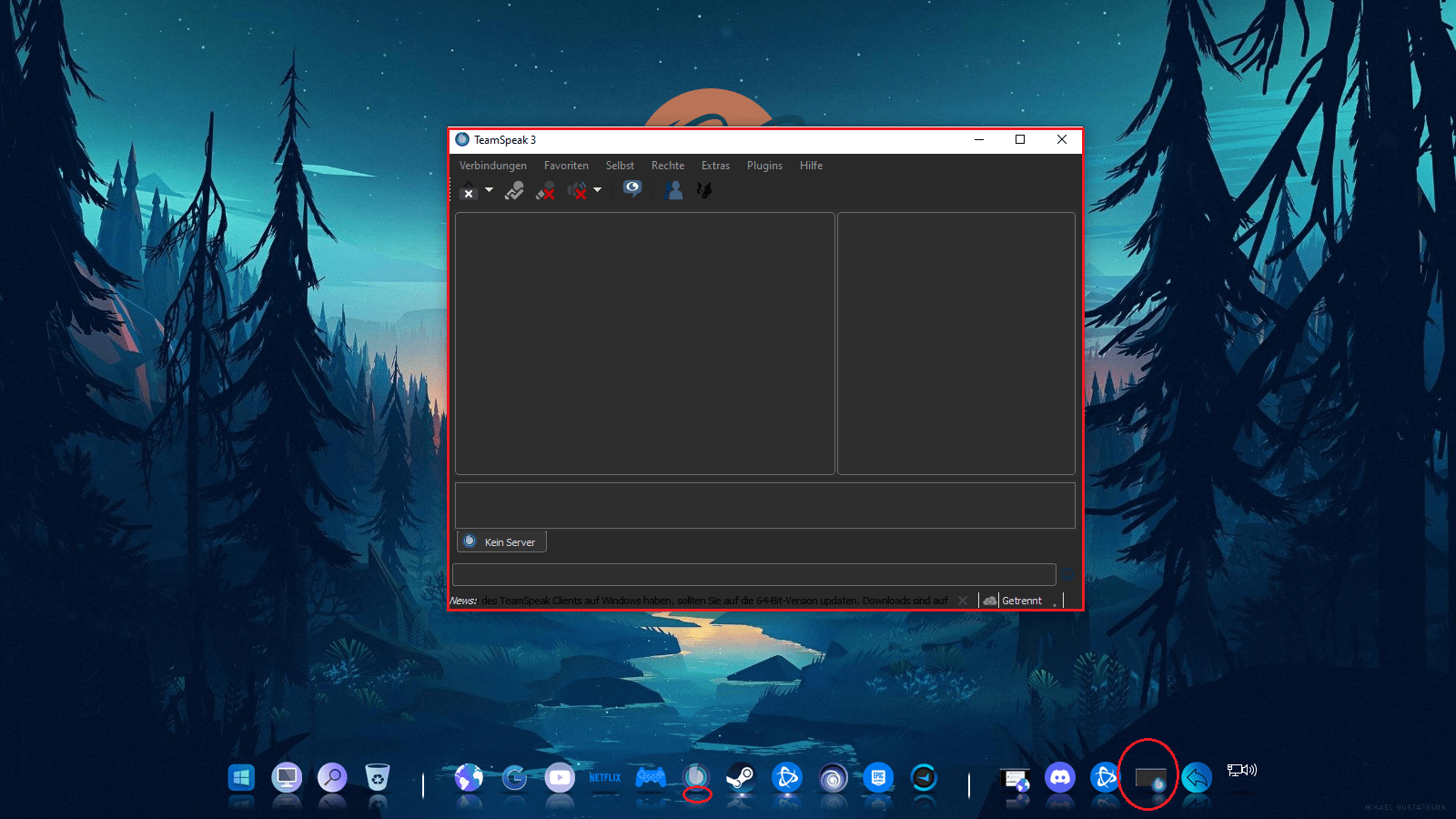

3: Yes Sir, it only happens with Steam and Battlenet. BUT I figured out just a few seconds ago that the Indicator is not working for other apps. As you can see, I have a TeamSpeak 3 Shortcut in my dock. When I run TS3, it opens but the shiny Indicator dot is not there. Thats for all other apps I have in my dock. To summarize it: Steam/Battlenet always indicates as "running" although they aren't while every other app does not indicate as "running" although they are. It feels like "Running Indicator" is stucked in some way or that the app icons do not refresh themselves when I start/exit an app.
4:Yes Sir, you are right. It is Win 10
5: No Sir, like already said at "3" the Indicator is not working for any apps that are running and for Steam/Battlenet the indicator is there permanently without running the apps. That never change.

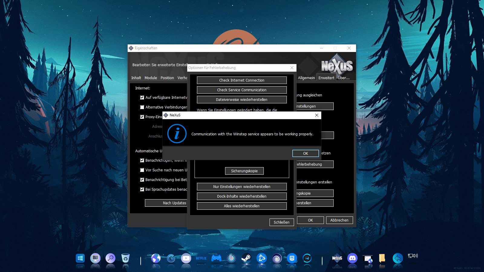

6. It says:

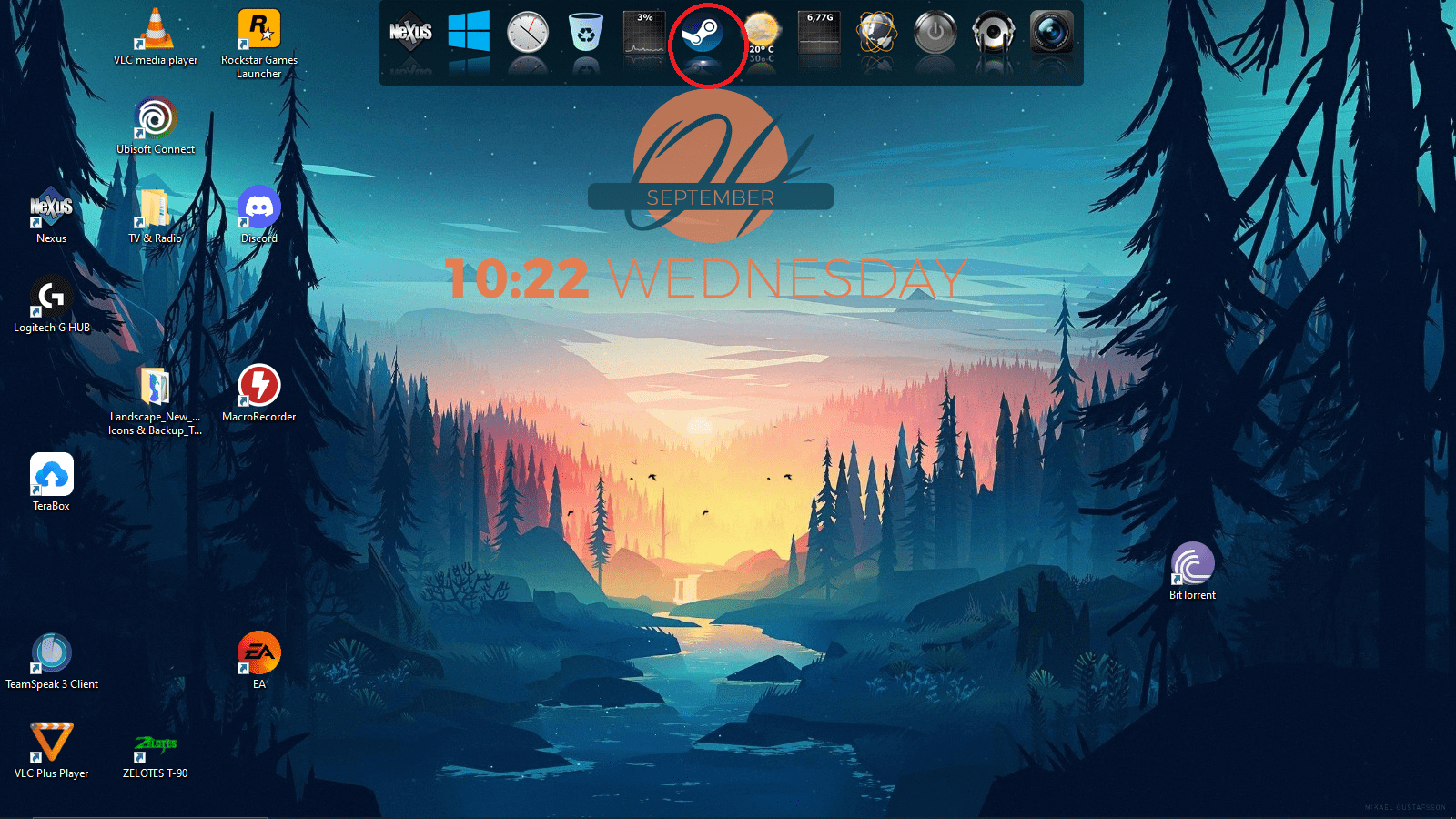

7. Yes, after resetting everything and making a backup before resetting and re-adding Steam to the fresh/new dock, the same bug occurs again:

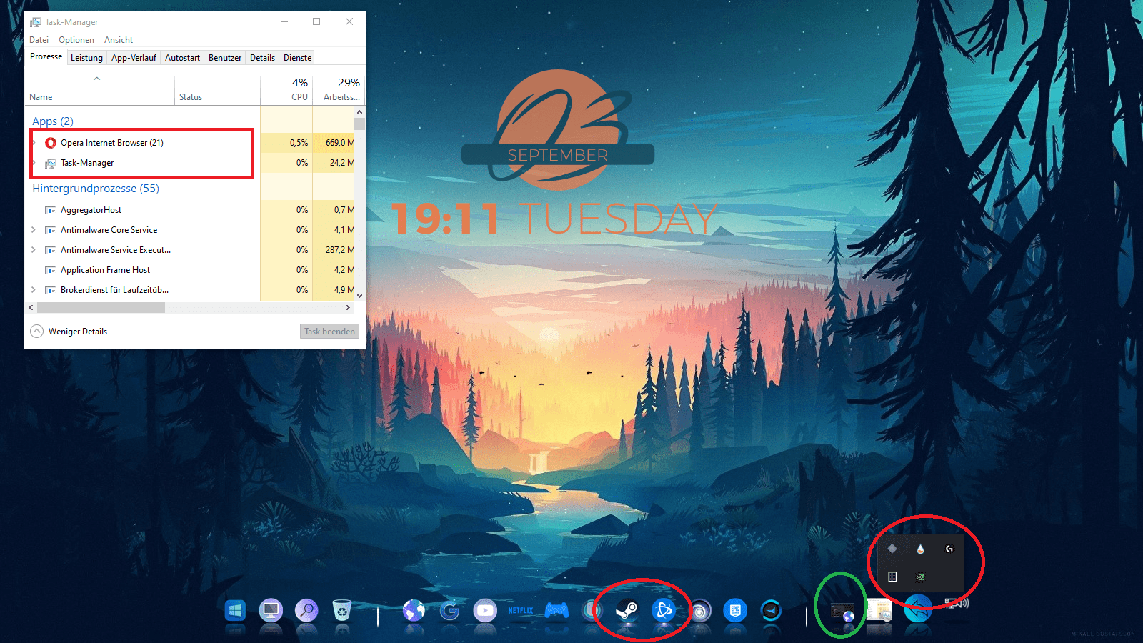

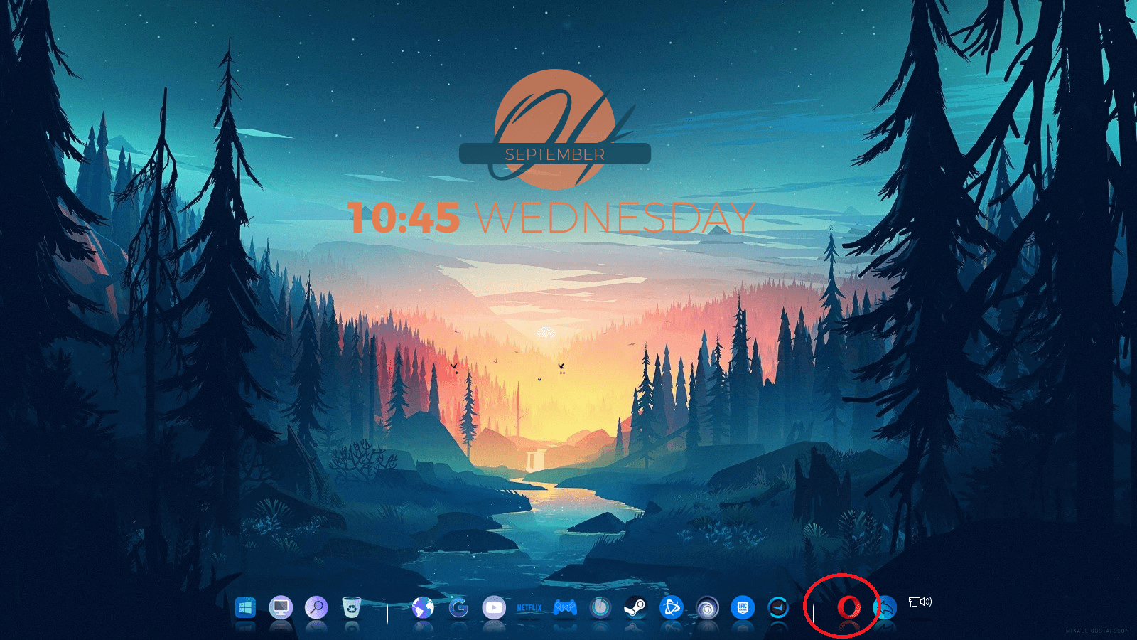

The only little "problem" I have now is, that the icon for my active browser (opera) now shows like this:
But it should look like this: (Ignore the red circles, it is an old screenshot. Focus on the green circle.
It is not that big deal, but maybe you can help with this also :)
