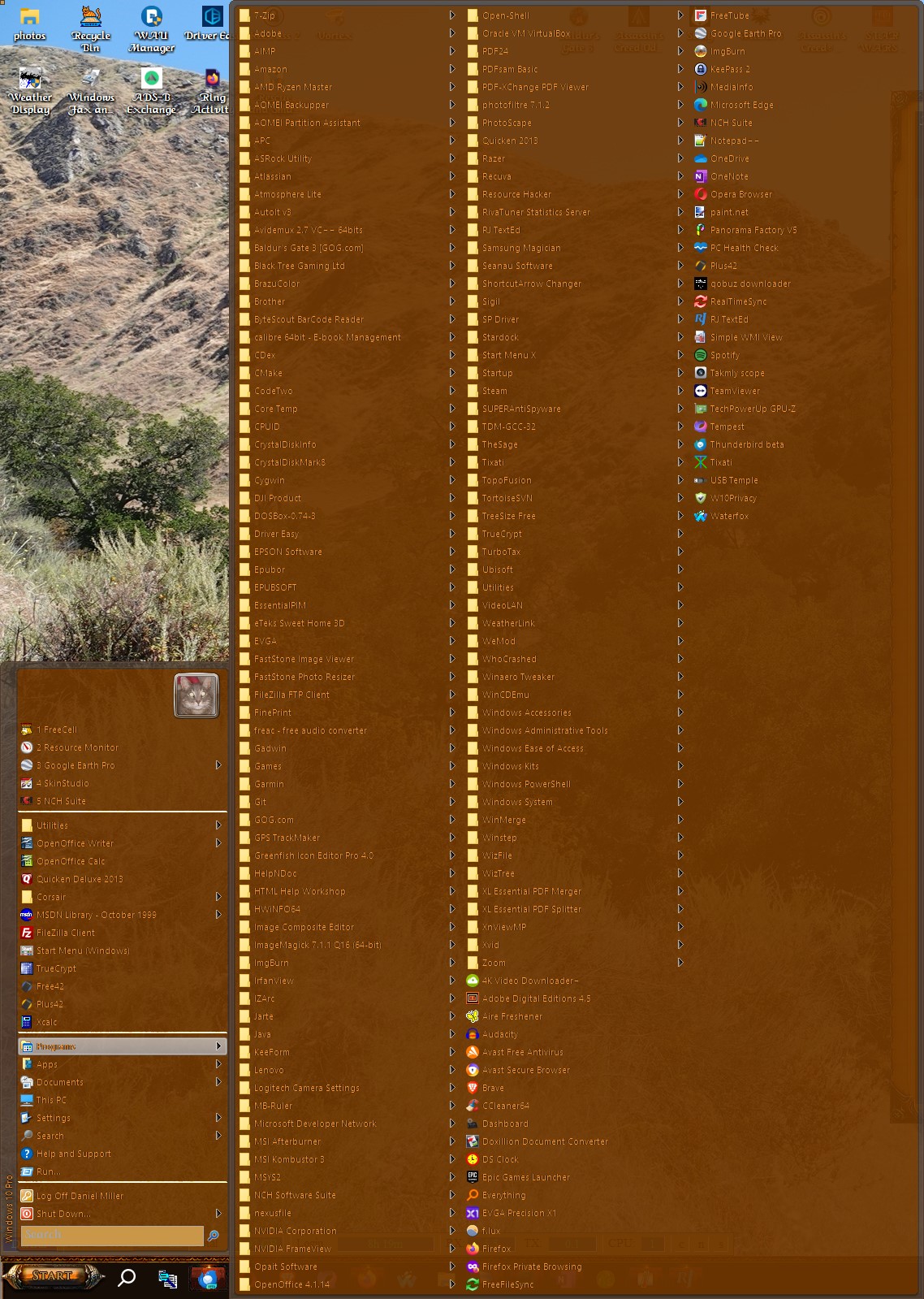

hmmm... okay, permit me to clarify my ultimate goal here...
First of all, I *DESPISE* the Windows 10-Style box menus... my entire goal in life is to avoid that!! What I require is the classic, simple, flexible Windows XP style cascading start menu. Check out the enclosed image of my existing Programs menus, to get an understanding of why the other solutions are unacceptable to me!
Although I use WindowBlinds, I do not use their Start 10/Start 11 Start Menu, because it does *not* have cascading menus, and in spite of my repeated requests, they apparently have no interest in doing that. So they are stuck with the cruddy scrolling Windows 7-style crud, or the Windows 10 boxes...
I've been using Open Start Menu, which does exactly what I want, except that WindowBlinds does not apply its skins to OSM... so I've been continuing to search for a skinnable Start Menu with the XP-style cascading menus.
The Grid Stack solution that is shown here, does not appear to provide even close to what I want, it's still just a matrix of icons.
However, it *does* sound as though the Winstep Startmenu might do what I want, yet at least allow me to skin with Winstep themes, even if I couldn't use WB themes...
However, is there a way to import my existing, huge Programs menu tree into your Startmenu?? If I have to create it from scratch, I'll probably never get around to it...

Unless you painfully added those items one by one to Open Start Menu as an internal private structure of that application (and I think not, I think it is just the plain old folder based Programs Start Menu structure that Open Start Menu is using) you won't need to import anything.
The main NextSTART menu is a menu created with the built-in Menu Editor (which you can modify at will) but the Programs item on that menu basically acts as the old XP All Programs **cascading** menu(s), browsing - and showing you - the actual Programs folder structure in your hard drive (Windows 8,10 and 11 used an hybrid solution based on an internal database rather than the old folder structure holding shortcuts to the applications installed on your system).
Anyway, Winstep Xtreme has a fully functional 30 day trial, so I suggest you download it and try it out for yourself to see if it suits your needs. If you are running Windows 11 22H2 or later you might have to manually set the Windows taskbar to auto-hide though (before MS broke that too, the Winstep application did this itself).
Since you would be using the old All Programs folder structure with the NextSTART component of Winstep Xtreme, even the Winstep Start Menu Organizer app included with Xtreme could be useful to help you re-organize that monster of yours, should you wish to do so.

The Winstep Startmenu will let you do what you want quite easily, as per Jorge's instructions above. :)
But, holy crap! That menu is a nightmare. Huge? It's absolutely humongous! At the very least I would recommend creating appropriate category folders to organise that beast. :) Again, the StartMenu Organiser mentioned by Jorge could be a great help there. One caveat though - I used it in the early days of Windows 10 and at the time found it difficult to reverse the process, but that may not be applicable any more, and YMMV.
Heh!! You know what, though?? I *love* that structure... everything that I want is right there, readily available... and with my 30", 2560x1600 screen, I have plenty of room to see everything...
Yeah, a few of the less-commonly-used applications could be moved to holding folders, but in the past I've found that caused confusion; whenever a program wants to update, it creates new copies of its folders in the root Programs folder, and I end up with multiple copies which are a pain to manage... I prefer it this way!!
and so, I guess you can see why I love cascading menus?!?!
