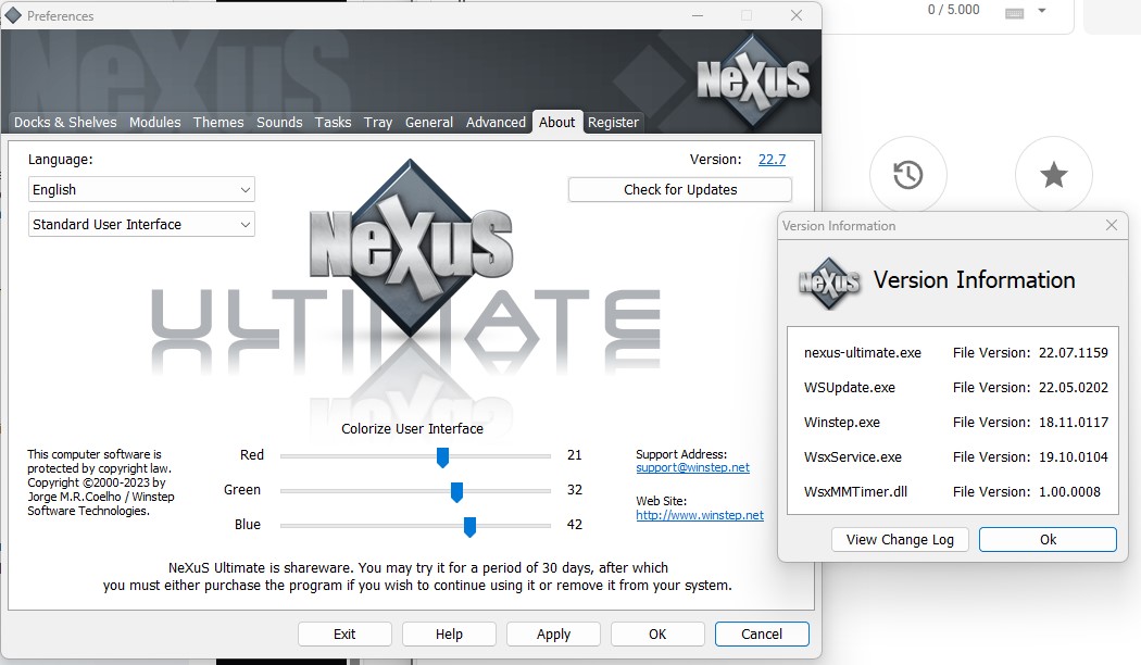

I work with Windows 11 Pro version 23H2. I also use StartAllBack because otherwise the system tray display in the dock doesn't work properly.

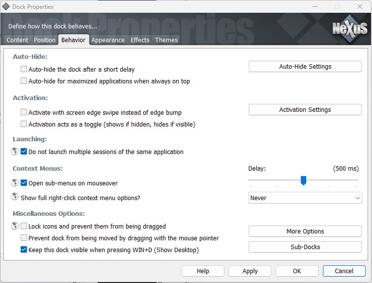

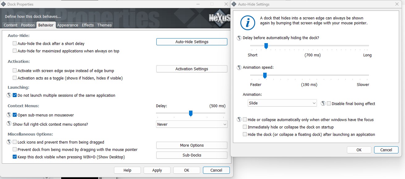

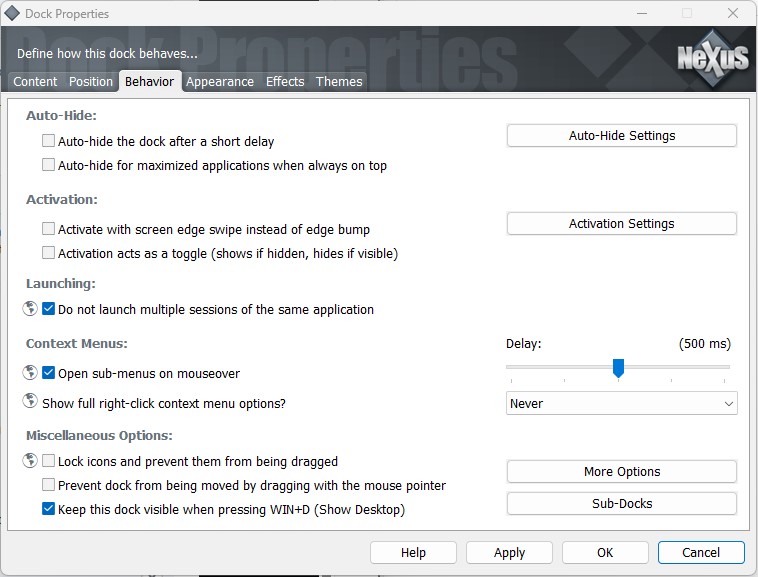

Maybe you have an idea why this sometimes happens and why sometimes it doesn't. Attached are the screenshots you want.
Best regards

I am using the same version, 22.7 under Windows 10 and have also encountered the same problem in the past. I change my desktop very often so I'm not 100% positive, but I believe changing the "Activation Settings" under the "Behavior" tab to what I have in the illustration helped. I believe I changed the "Edge Bump Settings" also.

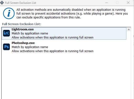

The dock is designed not to activate when a full screen app is open (typically games, so it doesn't accidentally activate - bringing you back to the desktop - just as you are about to shoot someone in the face in a fast paced FPS).
This said, not sure if it is already in the v22.7 beta (and if not it will be in the next official release) but under Dock Properties -> Behavior -> Activation Settings you now have a button that says 'Full Screen Exclusion List'. In there you can specify exceptions, so that Nexus will activate regardless of that particular application being full screen or not.

Unfortunately it didn't work. The dock shows up in all apps - only in ADOBE PHOTOSHOP and LIGHTROOM it doesn't come to the foreground. For example, if I use the keyboard shortcut to open Explorer and move the cursor to the bottom edge of the screen, the dock appears immediately. If one of the graphics programs named above is active, it doesn't work.
 Post subject: Re: App in full screen mode and the dock cannot be opened.
PostPosted: Wed Nov 22, 2023 11:21 pm
Posts: 13118
Can you please post a screenshot of your 'Full Screen Exclusion List' dialog?

Also, could you try the Full Screen Exclusion list with something other than those two applications (e.g. setting your browser to full screen by clicking F11 after adding it to the list)? I just tried it here with Firefox and the exclusion list IS doing its job as it should.

I acted according to the instructions. Edge added to the exclusion list. Opened in full screen and I was able to access the dock. Removed from the list and I couldn't access the dock. Run the program you provided and start the Adobe programs. I was able to open the dock. But: the dock not opening doesn't always happen! Only in certain situations. But I can't say what I did with the program shortly before...
