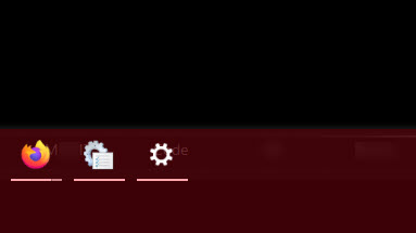

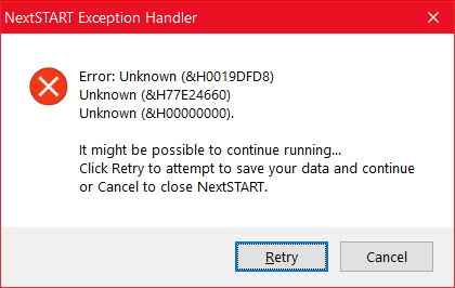

I got this error message (see attached image) when I resumed my computer from sleep/screensaver. In addition to this error, winshelf got hidden behind the taskbar (see attached image). I had to quit and restart winxtreme to get these back up and running. This happened a few times so far.

On a side note, sometimes all of a sudden winshelf (collapsed) gets hidden behind windows i.e., maximized window overlaps and covers winshelf and no matter what I do it does not come to the front and I have to restart the app to get winshelf to occupy the reserved space.

Thanks. This issue happens only when I resume my computer from sleep mode. Now, maybe this issue occurs when I sleep my laptop and I see the error window when I resume computer, I don't know. But, either way the screenshot I included contains some error codes and I think Jorge can perhaps quickly look at the codes and troubleshoot the issue.

I understand your frustration, but if you look at the error dialog in your first post, you will notice that all error codes are 'Unknown'. It's not normal for the Winstep application to crash after resuming from Sleep, or we would have a lot of pissed off laptop users joining this thread.
So this is, more likely than not, system specific, which makes it very difficult if not impossible to debug. Even some Windows new features might be causing problems.
What this **might** mean is that the crashes **might** be being caused by 3rd party software installed on your PC. Some software likes to 'inject' code of its own into the process space of other applications, and if this code is buggy or not well tested it can cause problems for THAT application (since it runs in the application's process space, it's the application that crashes, leaving the user thinking the bug is in the application when in fact the application itself is 100% innocent).
Anyway, have you tried experimenting with your system a bit already instead? Are you using Hybrid Sleep, for instance? Read THIS. Also read THIS, especially the section titled "To disable Hybrid Sleep".
