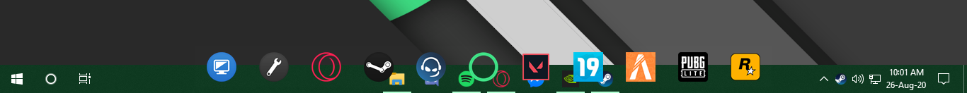

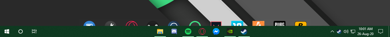

I have been getting this bug, for a day or two now, and it just recently started, although I did not face this during the first few days of using Nexus Dock
The problem I'm having is this: Sometimes clicking on the Windows Taskbar, and then clicking on the desktop makes the Windows Taskbar go behind the Nexus Dock, thus making it difficult to select the icons on the Windows Taskbar. Clicking on the Windows Taskbar's body again seems to bring it in front of the Nexus Dock, but the problem will repeat itself if I again click on the desktop.
For information, I have checked the preferences, and all of them have got to do something along the lines of "Keep Nexus Dock behind all apps i.e on the desktop". I also have the taskbar minimized from the Windows 10 settings.
What I've tried to fix this but didn't work: Make a backup of the current settings and then reinstall Nexus Dock and re-load that backup. I HAD TaskbarX installed, but I uninstalled it to see if it fixed it, but it didn't. I also tried messing around the settings but that didn't fix it either. I also tried to see if Cleaning the registry entries using CCleaner and restarting would fix anything, but to no avail.
The only thing that I have yet to try is reinstalling Nexus Dock but instead of reloading the backup, I'll start customizing the settings from scratch.
If anyone else knows any fix to this, please inform me... T.I.A
P.S : I have attached screenshots in order to help visualise the issue
File comment: What it looks like
File comment: What it should like

I always fail to understand why some users want to have the Windows taskbar and the dock occupying the same position on the screen and then complain when it doesn't work. The answer is simple: because it was never intended to be used like that.
You have a 'respect space reserved by other docks, toolbars and screen objects' - use that setting to make the dock sit above (above, NOT 'on top of') the taskbar. You can also prevent the dock from being covered by maximized windows by selecting the relevant option. You can also use the screen edge offset feature to move the dock above the taskbar.
What you can not reliably do is have the taskbar and the dock occupy the same position on the screen - this will always lead to a conflict between the two toolbars.
