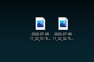

AlanWade wrote:
If I delete any files off my desktop they disappear just as they should. If I stop and restart Winstep Extreme they reappear in the sense that they cannot be deleted again as they are not really there (does that make any sense?)
Unfortunately no, that does not make any sense to me - Winstep does not magically 'bring back' files you have deleted.
Can you please be more descriptive to what you are doing, what you are deleting, and what exactly happens and HOW it happens, please?
Any files, but mainly images that I have on my desktop when deleted return after restarting Winstep. If I cut and move they dont return but if I delete them they or rather their icons return to my desktop which requires a reboot to lose them. I dont know how to explain it any better than that other than the screenshot I have posted.

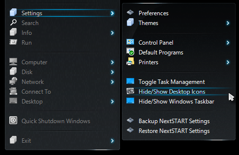

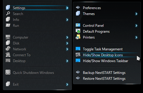

I don't understand this. Do you have Winstep hiding your Desktop icons and that's why you're quitting Winstep? Or do you have some part of Winstep completely covering your Desktop?
If you just want to show/hide Desktop icons, in my NextSTART menu (which is relatively default), there's a "Hide/Show Desktop Icons" in the Settings sub-menu.
