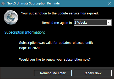

Hi,
First of all I would like to thank you for the wonderful software. I have been a subscriber of Nexus Ultimate for the last 5-7 years (don't remember exactly) and I definitely plan to be in the future because I like it very much.

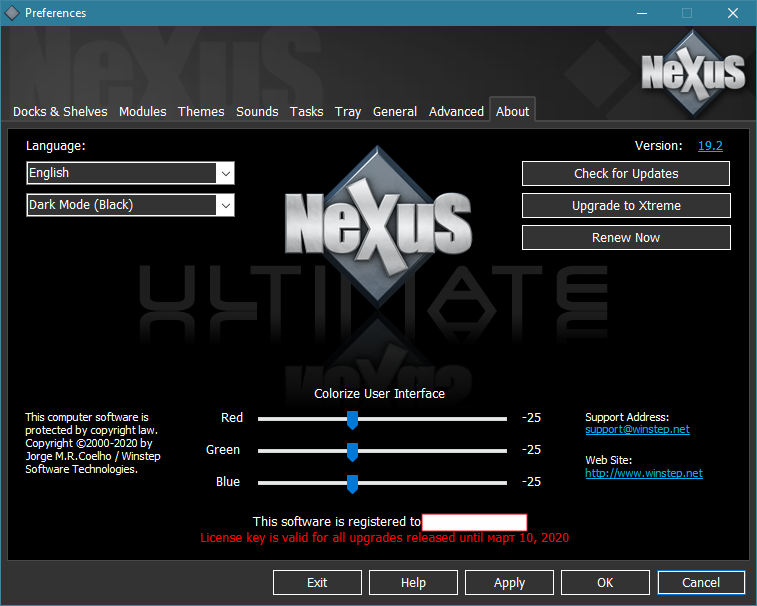

I have the following problem. My yearly license expired 4 days ago and I still haven't renewed. The subscription reminder popup comes out every 2 minutes even when I tell it to remind me in 1 day or 2 weeks - it continues to pop out every 1-2 minutes.
This is very annoying because the popup always places itself on top of all windows.
Is this "nag" done on purpose? I mean, of course the reminder is on purpose, but I guess the postponing options should work I guess.
I tried everything - clicking the "Remind me later", clicking on the X to close it, clicking on "Renew now", set it to "Never" - nothing stops the annoying popup.
Yes, I will renew but I would like to do this at my discretion :)
I have the latest 19.2 version on Windows 10 64-bit.
Thank you in advance!

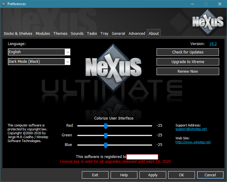

Just wanted to add that the license is working, although expired.

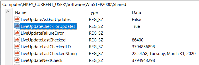

Initially the data was not there. I waited for the popup, set it to "Never" and hit "Remind me later" (there is no OK button in the dialog :) ).
Refreshed the registry and the value appeared:

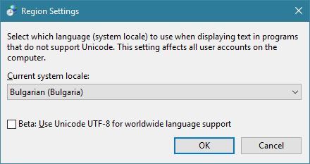

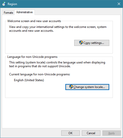

This made me realize that I have my locale set to Bulgarian and I need to change the Windows setting that takes care of non-Unicode programs:
Changed it to Bulgarian:
and restarted.
After that I repeated the process and the value this time is "мар 15 2021" which in English reads "March 15 2021".
Voila, the problem is gone!

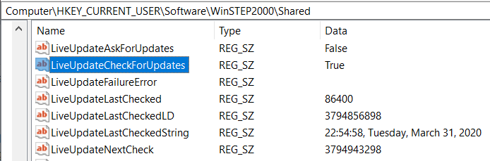

I've run in to this same issue and it's driving me NUTS. I was planning to upgrade in a few weeks when finances are a bit more stable, but now I'm sorely tempted to uninstall. Don't mean that to sound harsh, it's just constantly popping up and nothing has made it go away.
In my case the region settings are set to US English. I do have a non-standard short date format set yyyy-MM-dd. All other settings are standard. What should I check?

You're checking the wrong key name - that's for checking updates, not for subscription reminders. I'll send you a PM too.
