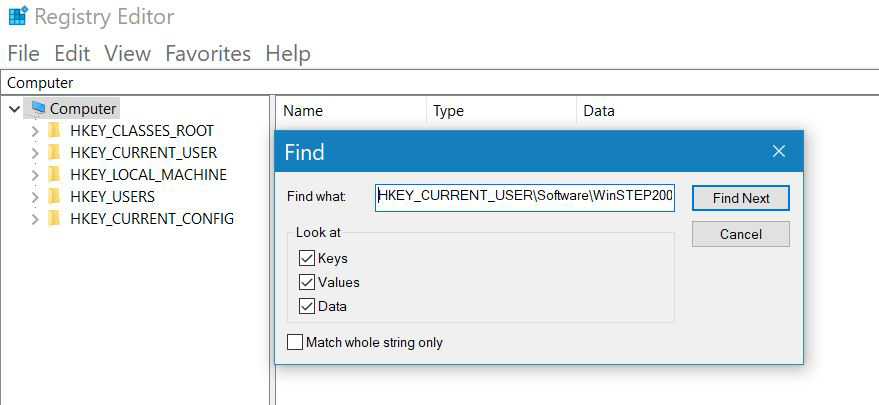

Nothing came up when I searched for that string in Regedit, with and without "match whole string only."
Would copying the Appdata Roaming files give me a backup?
Kami

Not sure it's a good idea for you to fiddle around in the Windows Registry if you don't know what you are doing, Kami. I assumed you had at least some basic knowledge.
In the left pane you have to click the arrow next to
HKEY_CURRENT_USER
to open that branch, then
Software
under it
and finally find the
WinSTEP2000
branch. It works just like a folder structure in Explorer.
Again, if you are not sure what you are doing, please ask someone who knows to do it for you - you can really hose your system if you do the wrong thing there.

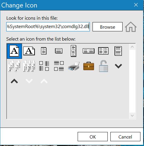

I just "found" the comdlg32.dll file in the System32 folder.
I first typed it in the Change Icon window, and some icons showed up. (see screenshot).
Then I saw it in Win Sys32. As mentioned, I ran scans which showed no corruption.
Could Nexus be looking for it in another folder?
P.S. After posting this, I re-installed. For now, it's okay.

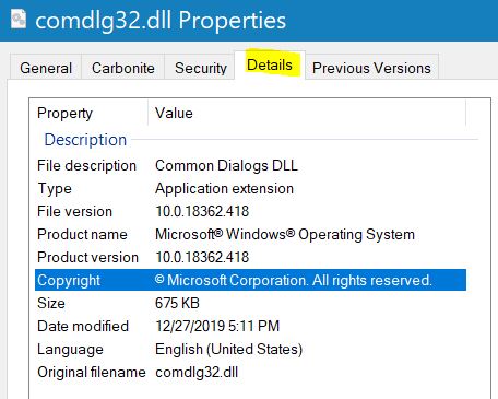

If you right click on Comdlg32.dll inside the SysWOW64 version, then choose Properties in the context menu, then go to the Details tab in the dialog that pops up, what is the File Version number and the Size of this DLL?
 Post subject: Re: Can't do Backups; Can't select shortcut icons
PostPosted: Tue Feb 04, 2020 7:29 pm
Posts: 32
The file in the screenshot was from Sys32.
From SysWOW64 (new screenshots attached):
Created/Modified: Dec. 27, 2019
Accessed Jan. 18, 2020

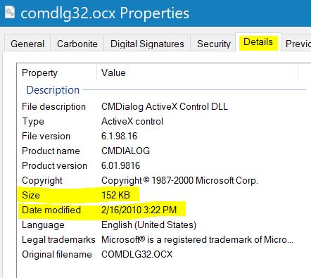

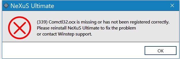

Also comdlg32.ocx - which appeared in a recent error msg
size 152 KB
created Jan. 14, 2020
modified Feb. 16, 2010
accessed Jan 19, 2020
The comdlg32.dll error popped up again when I tried to change an icon just now.
The *.ocx error popped up when I tried to open Preferences.
This message board doesn't seem to let me add the Property details screenshot of this file. I'll do another msg.

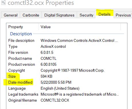

Here's screenshot of comctl32.ocx property details. The first Properties windows also shows Created Jan 16, 2020, accessed Jan 19, 2020.
Can't help but wonder if Nexus is a 64 bit app, then why is it using 32 bit apps?
