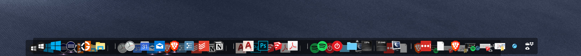

I have a dual monitor setup with separate docks locked to each monitor.
Anyone know why I keep getting my secondary dock move to the same place as on my primary monitor? Both docks are locked to the bottom of each screen so I cant understand whats going on.
Its quite frustrating as I have to unlock the dock which is stuck behind the other, move it back to the 2nd monitor and re-lock in place, which would be fine, but that in itself is a clunky process.
I'm guessing this has something to do with turning the 2nd monitor off. But does anyone know of a fix for this?
Thanks.
 Post subject: Re: Issue with Nexus Dock on Dual Monitor
PostPosted: Tue Oct 15, 2019 3:14 am
Posts: 13126
Well, yes, of course, otherwise the dock would remain inaccessible and off-screen. Docks and other Winstep objects automatically reposition themselves into the visible screen area whenever monitors are turned off or you lower the screen resolution. This ensures you can always access them.
The real question is: why do you turn off your secondary monitor? For instance, I have a triple monitor system here and all three are always turned on (even if in power saving mode).
Anyway, from v18.12 forward, Winstep implemented automatic multi monitor profiles. This means what you are experiencing should not happen when you turn off the second monitor (unless you are running a previous version or you turned that feature off in Preferences), i.e.; docks can have different positions for different monitor configurations.
What version are you running (and is it Nexus Ultimate or Winstep Xtreme) ?

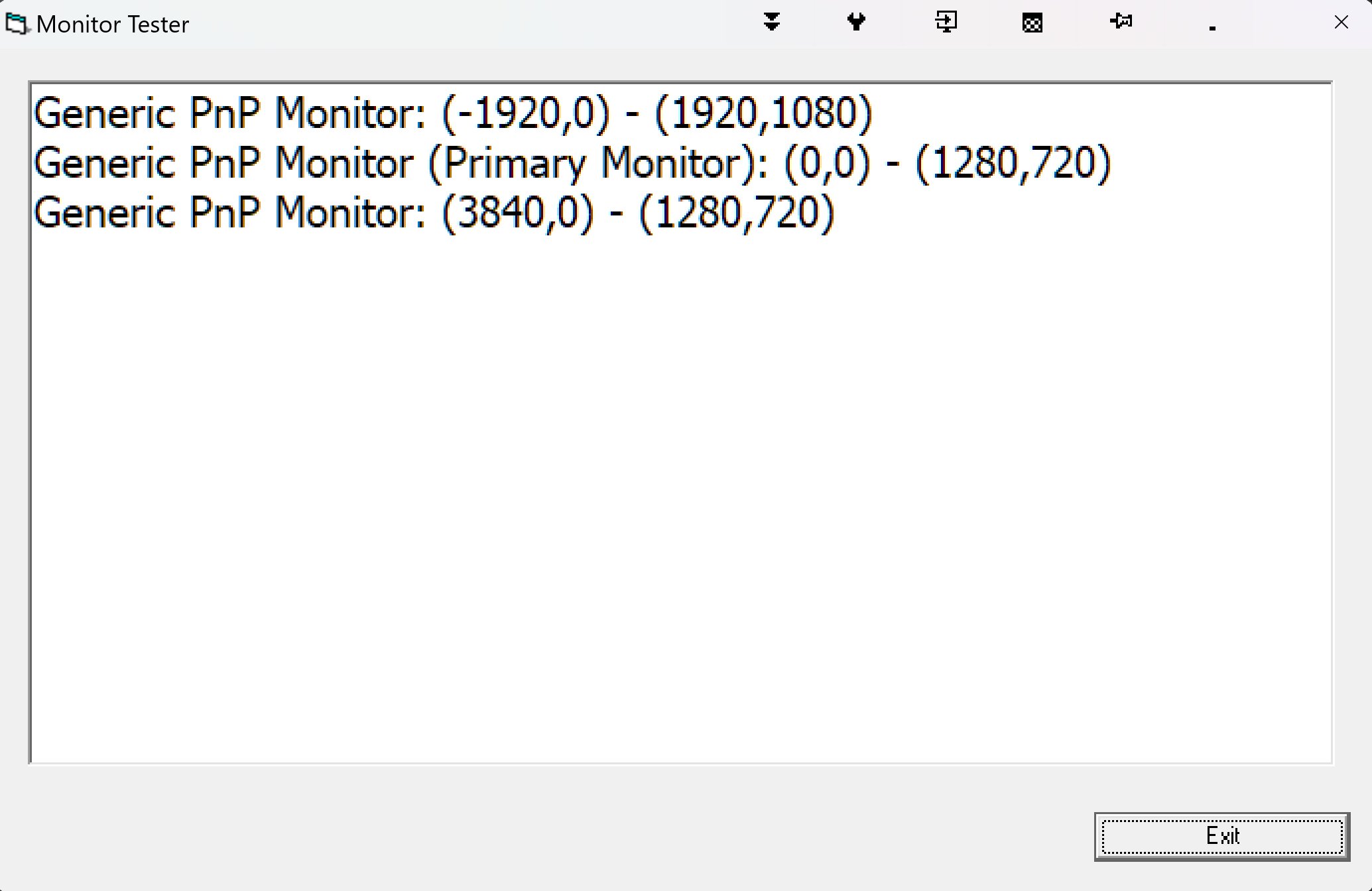

I have three monitors but the settings of workshell do not show this third monitor.
PostPosted: Sun Aug 11, 2024 7:59 pm
Posts: 13126
Download THIS FILE from the Winstep web site, unzip and run TestMonitors.exe then post a screenshot of the results, please. This will show what the Winstep application sees in terms of monitors and screen resolutions.
PostPosted: Sun Aug 11, 2024 8:59 pm
Joined: Sun Feb 18, 2024 9:41 am
Oke here it is.
PostPosted: Sun Aug 11, 2024 9:56 pm
Winstep thinks that the 1280,720 monitor is my primary but the 3840 is. And i have two 1920 screens.
PostPosted: Mon Aug 12, 2024 3:06 am
Posts: 13126
What you see there is what Windows is telling the Winstep application regarding the number of monitors and their resolution. Since you claim to have two 1920 monitors, this means Windows is lying.
This happens because one or more monitors have mismatched screen DPIs. Winstep applications are high DPI compatible, but they are not PER-MONITOR high DPI compatible. This means that for everything to work properly all monitors must have the same DPI (e.g. all 100%, or all 125%) otherwise Windows will lie to the application about the real screen resolutions and what you get is the result.
PostPosted: Mon Aug 12, 2024 6:39 am
Thanks that is the solution, i can now place the dock on all screens.
Mondriaan :D
