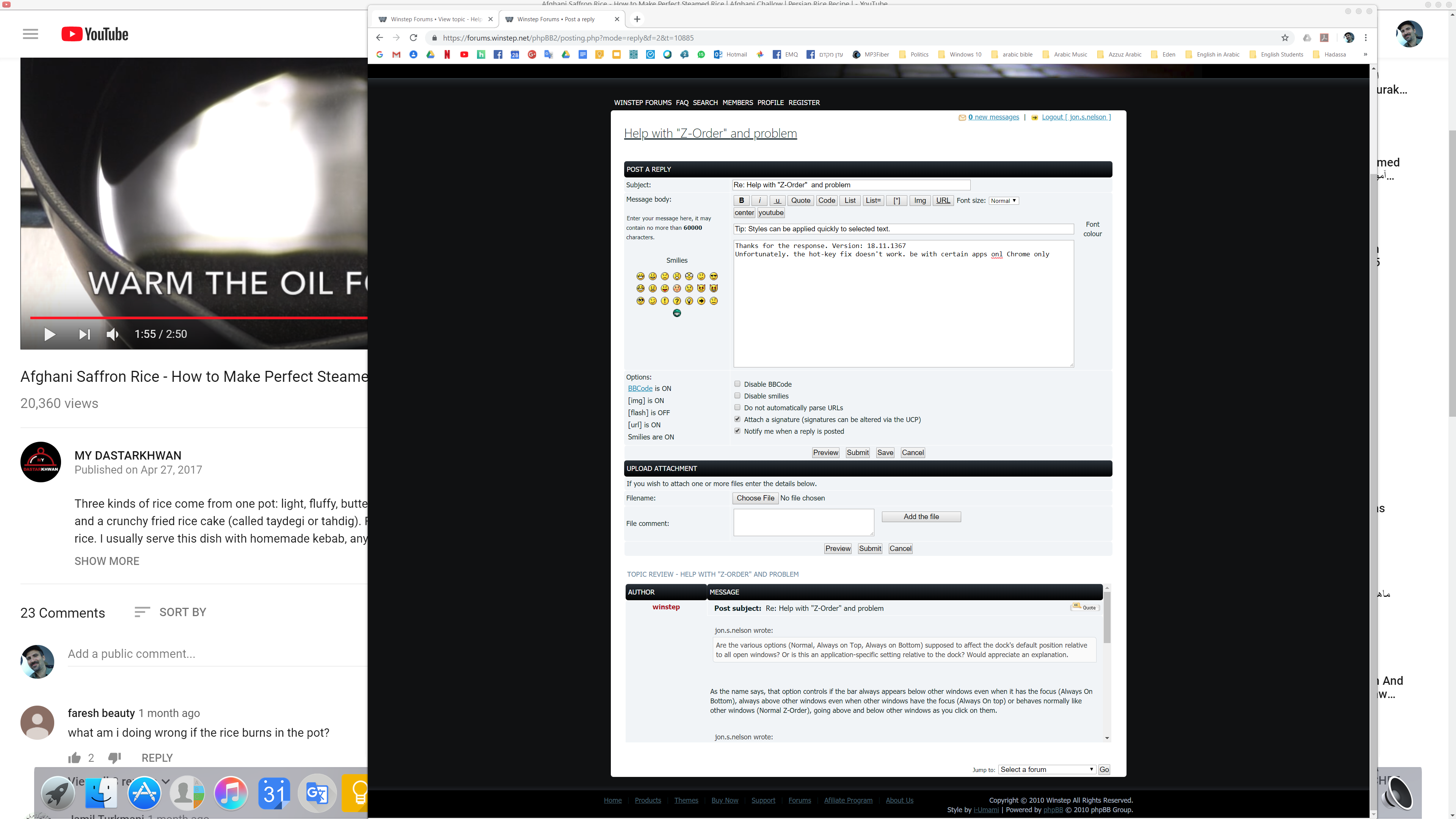

Unfortunately. the hot-key fix doesn't work for me. Perhaps the attached screen shot can shed some light. As you can see, the bar "refuses" to show up ONLY above certain apps (ie. Chrome) I reduced the window side of Chrome so you can see that the bard DOES show over other apps/windows. This is still the case with the z-order set as "Always Above".
Since I'm running Windows Blinds(by Stardock) which themes the title bar Chrome and other apps, it's possible that THAT is part of the problem. I'm just wondering if there is some way to force the bar to appear above Chrome in this case...
Also, I'd like to add that if I close Chrome, and reopen, then the bar DOES appear again over Chrome.
