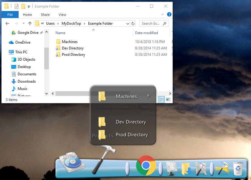

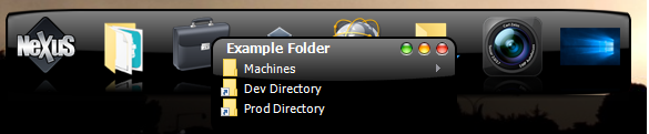

I am a new Nexus Dock user, but longtime user of RocketDock. Nexus has satisfied most of my needs, but I am having some issues with dock items that display menus. The issue are:
    - The text of the menu items are very small, can I configure them to appear larger?
    - The menus open next to the icon and not above which obscure the dock.
I have attached a series of pictures demonstrating the above issues.
Any help on this would be greatly appreciated.
File comment: Fig. 3 - Notice how the menu item is over the dock.
File comment: Fig. 2 - This hides dock items. Would be nicer if it appeared ABOVE the doc.
File comment: Figure 1 - This is how RocketDock with KKMenu displays items. Can Nexus be setup to display this way?

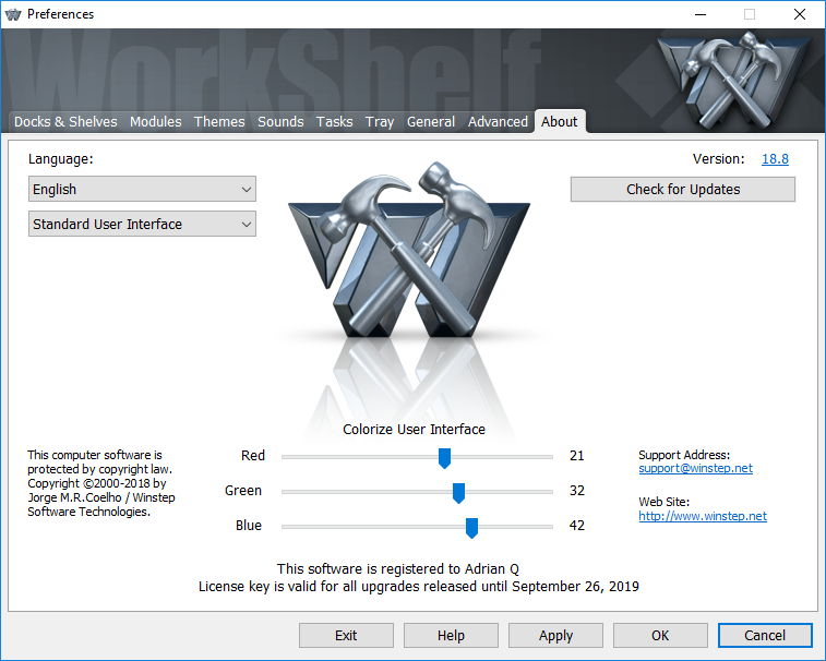

Can you please post a screenshot of the About tab in Preferences?

Here is screenshot of the About screen as requested.
File comment: About Screen

I went back and REALLY took a hard look at the first pic the OP posted. I think now I understand what was being asked.
I didn't realize that the first pic is RocketDock and the context menu is above the dock. I thought the OP was showing that Winstep was overlapping the Explorer folder in that pic, and overlapping the dock in the second and third pics.
