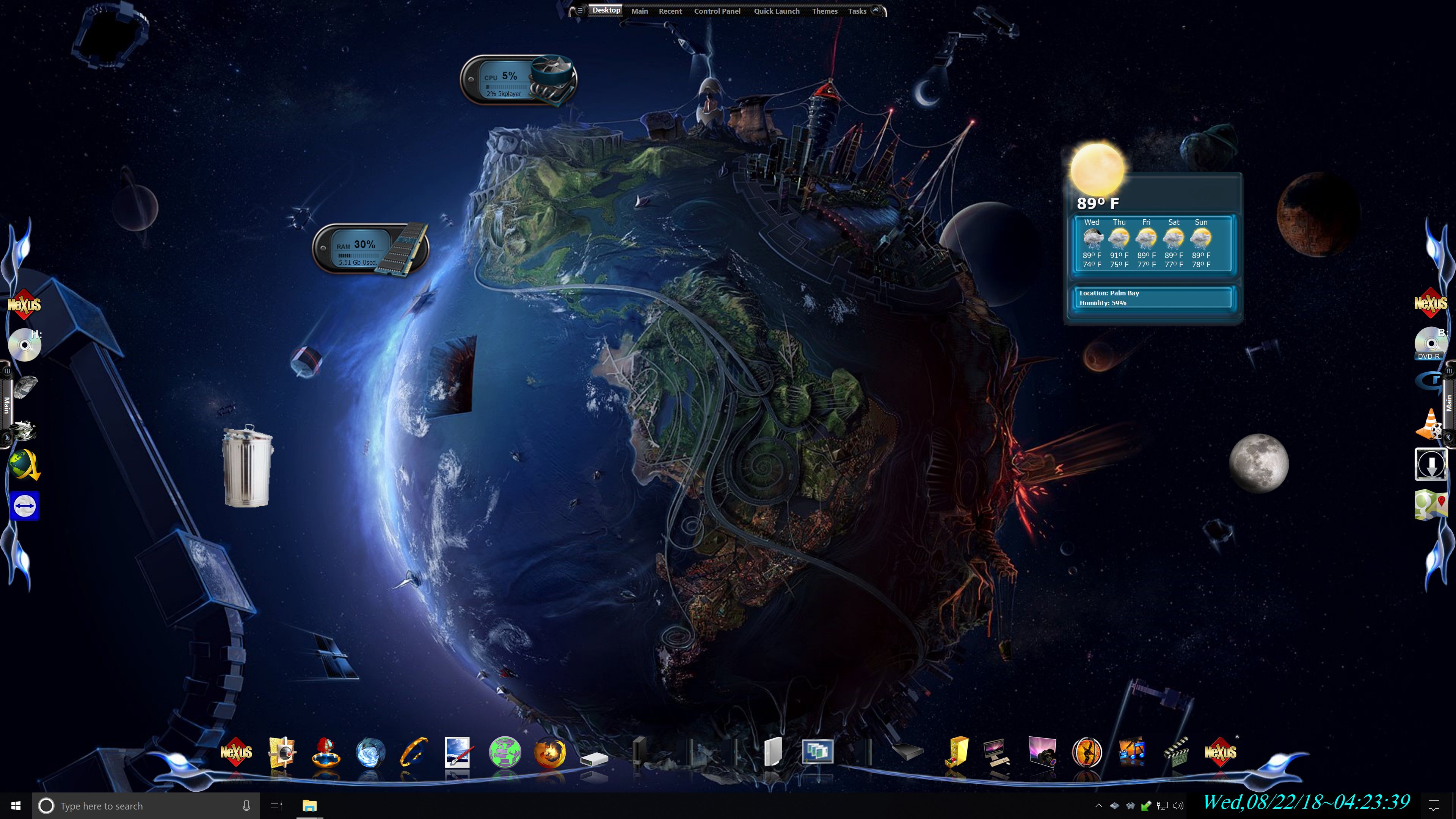

Jorge, I cannot find the path/folder to the Winstep CD Control icon. Instead of using the Drawer, I decided to use the Dock to open the CD/Drawer to make the appearance symmetrical since I use the CD Control icon on my other Dock to open and close my USB CD/DVD drawer.
Because I like the appearance of that icon, I want to replace the Winstep CD/DVD drive icon that's used when you drag the CD/DVD drive to a Dock or Drawer (the "Item type" becomes Folder) to that one since the CD Control Internal Command doesn't work on my PC for my internal Blu-ray CD/DVD drawer and the "Item type" Folder command at least opens the CD/DVD drawer.
How do I change the icon to the CD Control icon? Obviously, the "Item type" for both are presently "internal Command" and not "Folder".
Here is a screenshot of my Desktop with the CD Control icons that I took more than a week ago. BTW, your Moon Module looks awesome with my Desktop Background!
You don't. The CD Control icon is constructed 'dynamically' according to the drive letter and type of media inserted in the drive. The base image is a simple blank CD icon that's embedded in the application's resource files, and therefore not directly available.
