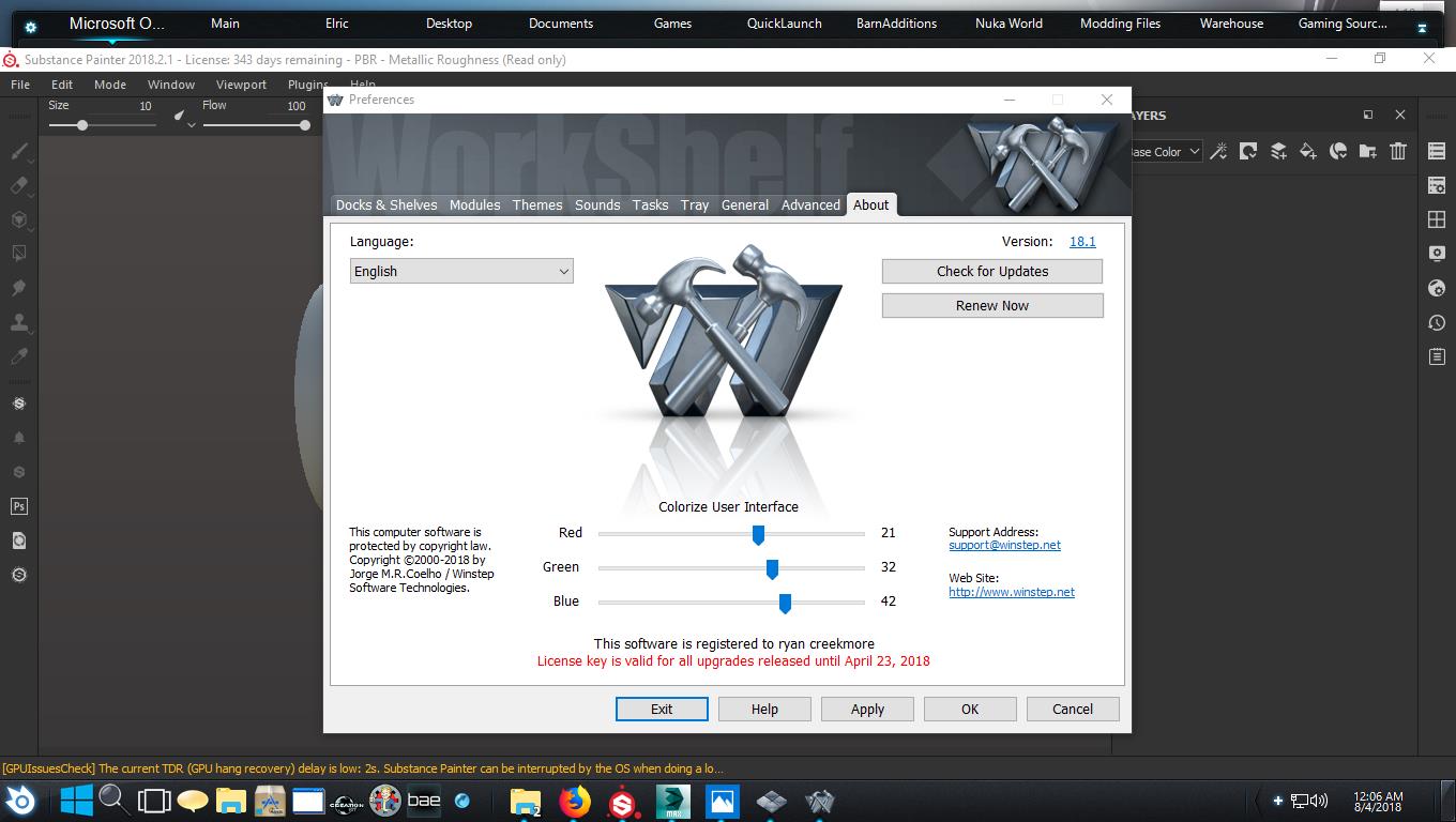

Can you please post a screenshot of the About tab of WorkShelf Preferences?
If you can't get to it, go to
right click on the WorkShelf.exe file, then select Properties, then click on the Details tab and paste the file version here.

Thanks for the screenshot - v18.1 is well within your period of free upgrades. In fact, even v18.3 is, so let me know if you want to upgrade to that version, I'll send you a link to it.

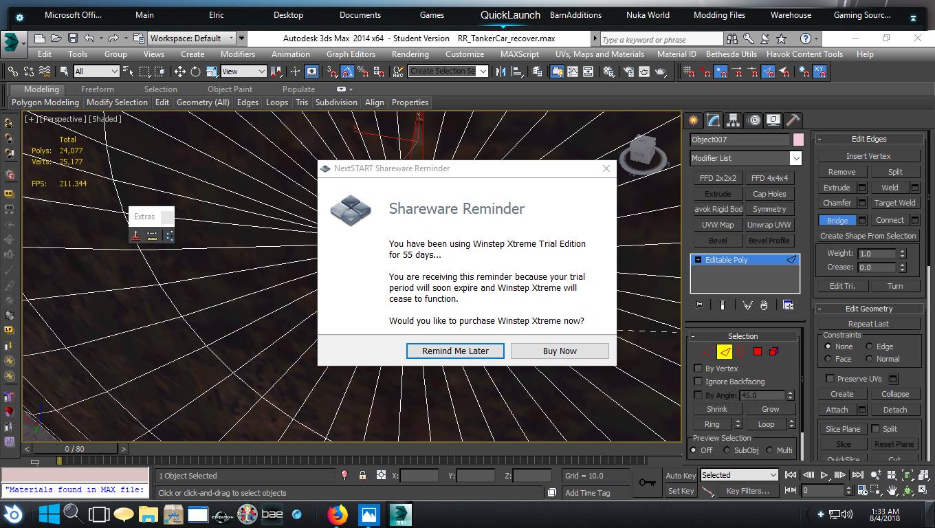

1.The window pops up every restart, I click open folder, apply, then OK.
2. There is no red dialog
3. The steps in answer 1 have no effect - it does not register.
It started I'm guessing about 2 weeks ago and I've had the same AV software for much longer, which I did check to make sure there was no conflict.
This popped up 5 minutes after post....

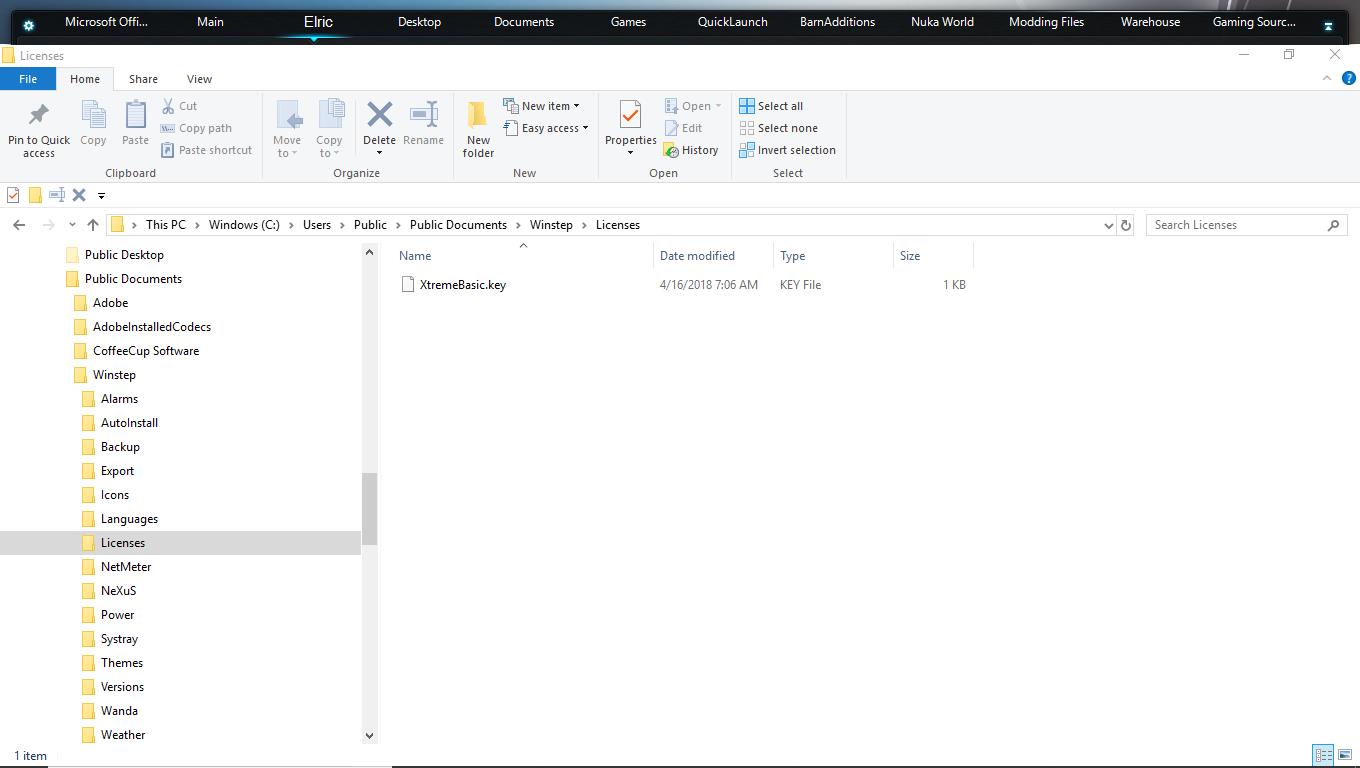

Ok, do me a favor: please post a screenshot of the contents of your
C:\Users\Public\Documents\WinStep\Licenses\
folder.
Then, next time it happens, click the 'Open Folder' button in the Registration tab of NextSTART Preferences and compare to see if there are any differences in content (or make a new screenshot and post here).

I do not believe it is registered and I downloaded directly Winstep.
