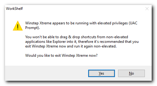

After a very recent update to Winstep Xtreme 17.1, it offers, on startup, an error message as attached.
It appears to be linked to the Workshelf element of the program.
UAC is off. I have not changed privileges. I have checked that "run as administrator" is off for the different elements of Xtreme, Workshelf included. Under Properties > Security for each constituent application, "Users" have full permissions.
Windows 10, version 1703, build 15063.726.
Is this a bug?

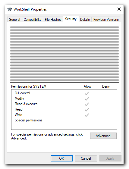

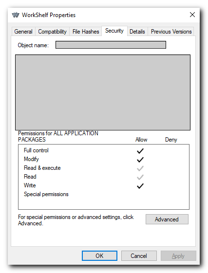

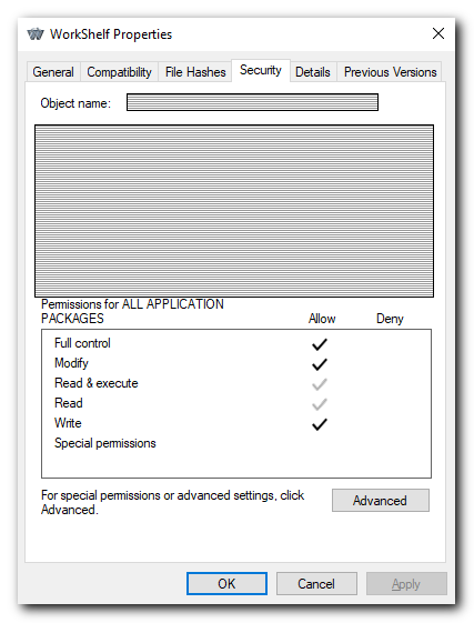

If I go into Workshelf > Properties > Security, permissions are as per the attached screengrabs (could only upload 3 of the 5).
For Admins, everything except Special Permissions is allowed, and nothing denied. For Users, the same.
Have I got them set right?

For Admins, everything except Special Permissions is allowed, and nothing denied. For Users, the same. Have I got them set right?
No, that is wrong. Under my Windows 10 system the Users group for the WorkShelf executable only has the 'Read' and 'Read and Execute' rights enabled.

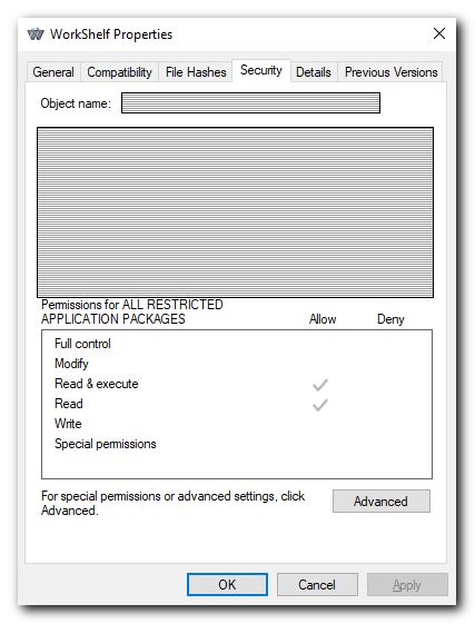

Under Workshelf > Properties > Security > Advanced, I disinherited Users, and Users is now down to Read & Execute, and Read, only.
Same with All Application Packages and All Restricted Application Packages.
System has full permissions, as do Administrators.
And yet I'm still getting the same flag.
