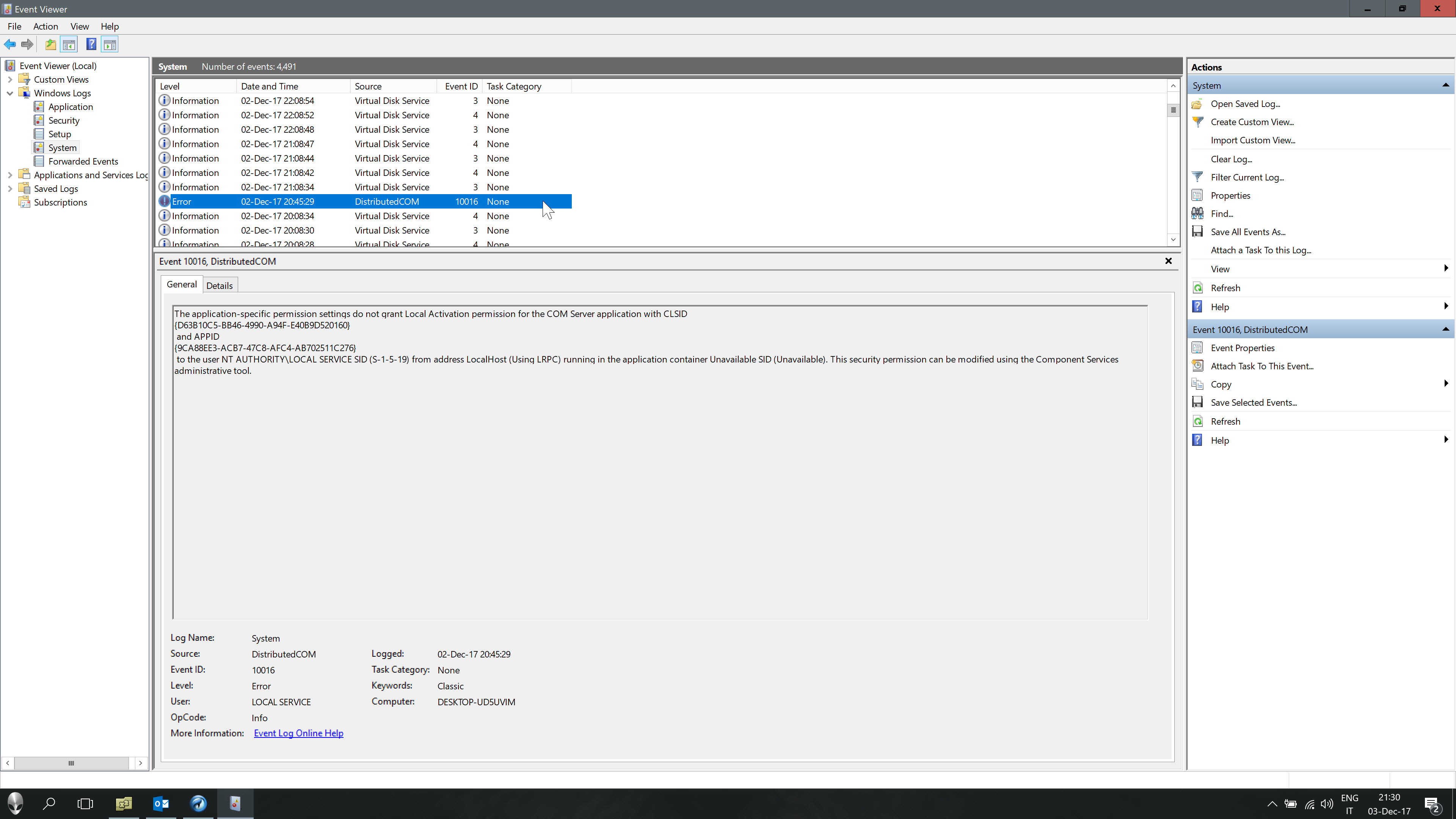

Hmmm... could it be a failing hard drive or external hard drive controller?
Check your Windows System logs for events with red exclamation marks (Control Panel -> Administrative Tools -> Event Viewer -> Windows Logs -> System).

There are numerous red exclamations in the Event Viewer but all are for the same error "Distributed COM" (see attachment) and they seem to be occurring throughout the day whereas the dock's freezing issue only happens just after starting up. I don't know what that means and the description hasn't made me any wiser. Could that be the cause?
