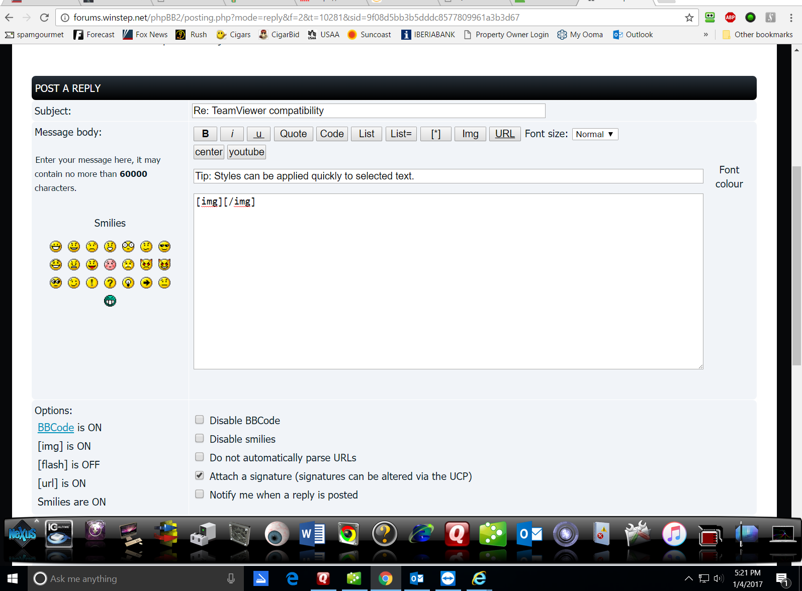

How large is your dock? Does it extend from one edge of the screen to the other? Perhaps a screenshot would help.
As you can see the dock is pretty much full width. I can remove some items if necessary to see if that makes any difference. Would two different size monitors make any difference? My primary monitor is a 19" 1600x1200 resolution (4:3 format) my left and right are 20" 1680x1050 (16:9) format.
