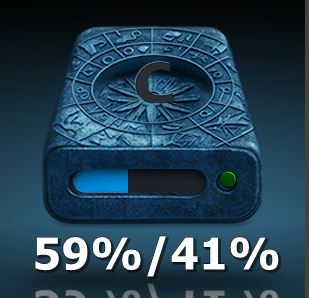

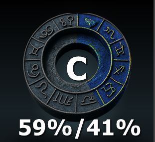

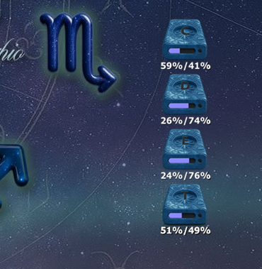

ALSO
It is always good practice to be creative and try new ideas.
That said, The most logical approach is not to be too creative because of expanding drives and size limitations.
Here are two I did for the Astrology theme. They work fine but do not look anything like intended and definitely do not look like this on the desktop when shrunk . Other than laptops, most people will not have only one disk drive so making the icon larger in the module itself is totally impractical.
Therefore, the smartest approach I have now found is basically to just match the colors of the theme and avoid being creative where it is easily lost when a tenth of its size.
Love those disk images.
While it is true - and a pity - that many of the icon details are lost at the normal icon sizes, it is also true that the user can, if he so wishes, scale up desktop modules up to 200%, plus increase the icon sizes of docks holding the disk meter icons, etc...
That is not something you as the skinner can control, but it does reveal the beauty of the details (and so does the Disk Information dialog, by the way, as the icon displayed there is pretty big).

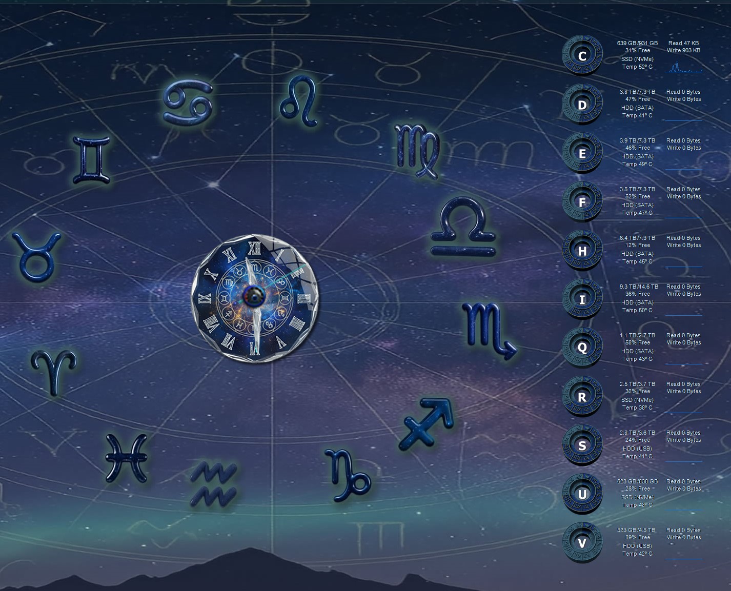

PostPosted: Sat Jan 10, 2026 7:57 am
Posts: 632
@JORGE

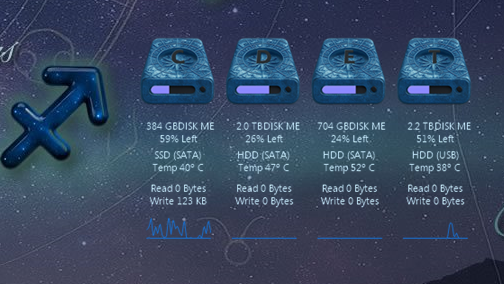

Here it is at 90 pixels in 2 views - using the defaults with only size adjustments and coloring.
It works. If a user only wants no more than five modules it won't matter if they have 26 drives. However, if they use all of them, it will be a bit crowded. :)
ALSO - did you mention that we cannot change the default color, position and size of the disk letters? I may have missed that. Apologies if so.
PostPosted: Sat Jan 10, 2026 10:33 am
Posts: 632
@JORGE

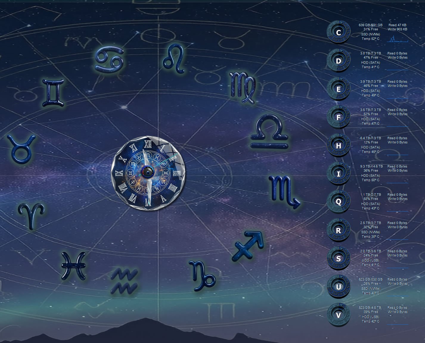

Ultra widescreen with 11 drives. 90 pixels is around the maximum icon size for now.
Is there a facility display the volume name? Just asking or if that is in the future?

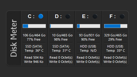

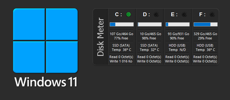

I've pretty much got it all figured out. Even though it's the most complex file compared to the other modules (RAM, CPU, Net...), I can do almost anything I want.
But I prefer the horizontal module; for the vertical module, you absolutely have to create a WsDiskV.png skin to maintain consistency and avoid flipping WsDisk.png.
I agree that Jorge has done an excellent job overall, but I don't need that much disk information, even though it's possible to remove some from the .wsd configuration file.
Also, I don't understand all the problems BassdudeNZ is having; maybe he's trying to do too much, I don't know.
In any case, I'm not encountering any particular problems except:
PS: Being able to change the color of the flashing LED, which always displays the original green.
Exactly. You can 100% pick & choose what information to display and what not to display. Up to you as the theme author.
wsDiskLED.,png
The LED has 3 levels of brightness and WsDiskLED0 is LED off. From those four led bitmaps you may provide WsDiskLED.png only, and the application will automatically adjust the source bitmap's brightness to maintain the 3 required levels of brightness. If you also do not supply WsDiskLED0.png (LED off) the application will grayscale the WsDiskLed.png bitmap and darken it a bit to create a "LED off" image.

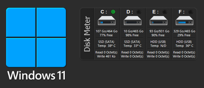

Posts: 55
Thanks Jorge, it's perfect, I understood immediately, I followed your recommendations, and the LED is flashing blue as I wanted.
Thanks again.

Posts: 55
I'm using a bar graph to replace the original bar on an icon that represents the amount of disk space used. I haven't tested the multi-slice functionality yet, but I'll do so for about ten images. I don't know why, but I could be wrong, but I think the multi-slice functionality will work for reading or writing, a bit like RAM, CPU, or network usage.
What do you think?
Another thing, which isn't really important, is that the temperature of an NVMe hard drive in a specific enclosure connected via USB isn't being recognized.
Thanks...
