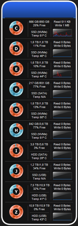

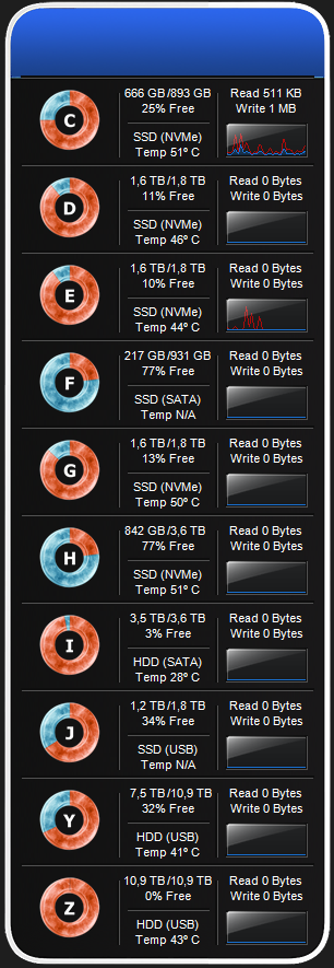

PostPosted: Fri Jan 23, 2026 9:42 am
Posts: 13126

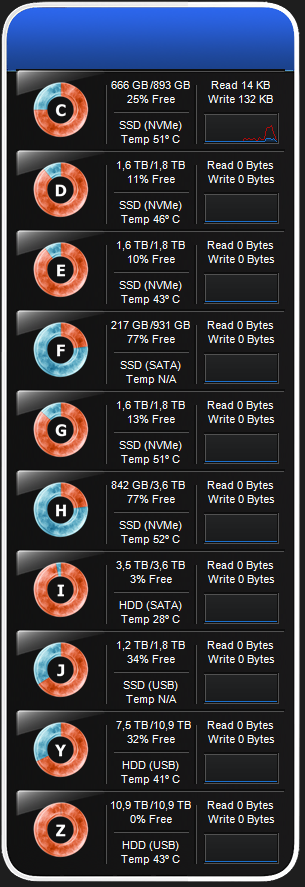

And there you go, a vertical iStat Disk Meter desktop module with a nice per-section glass reflection overlay:

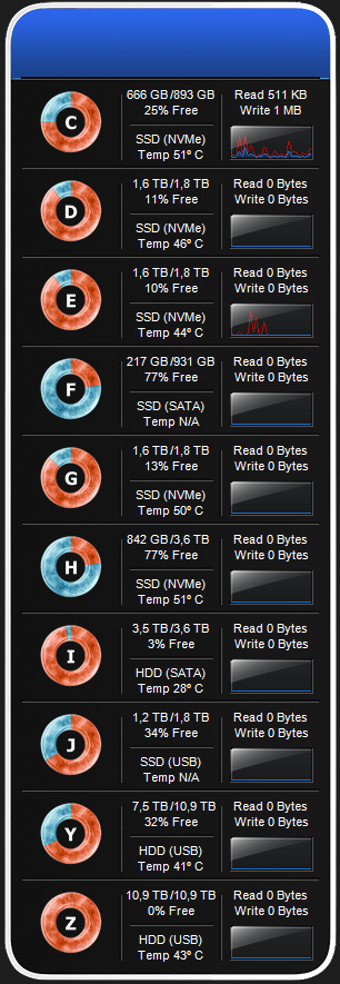

And one with a glassy histogram section:
So, the brand new section overlays seem to be working fine. :D

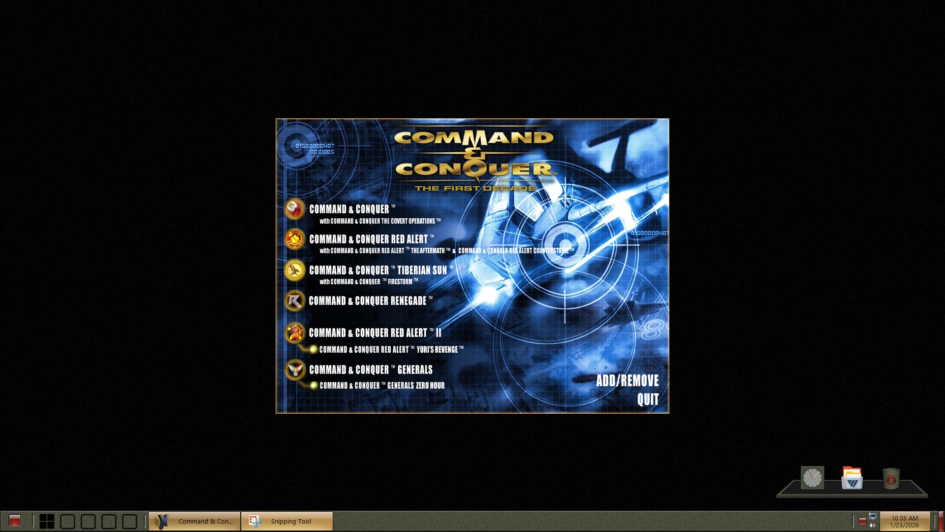

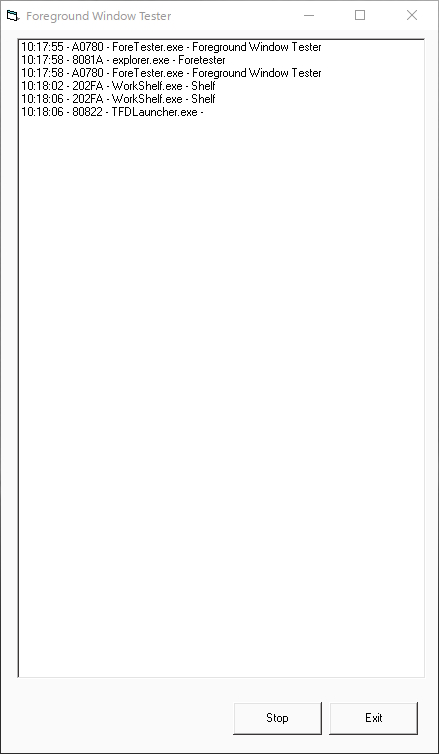

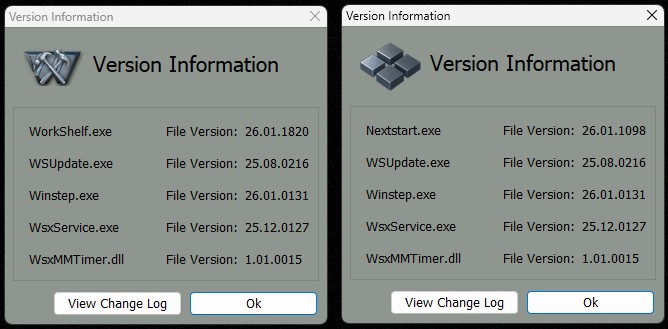

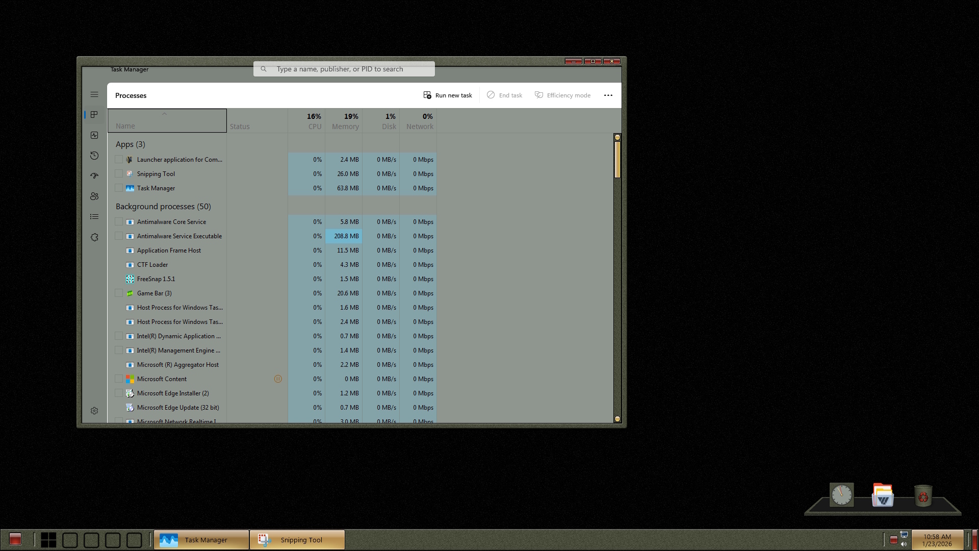

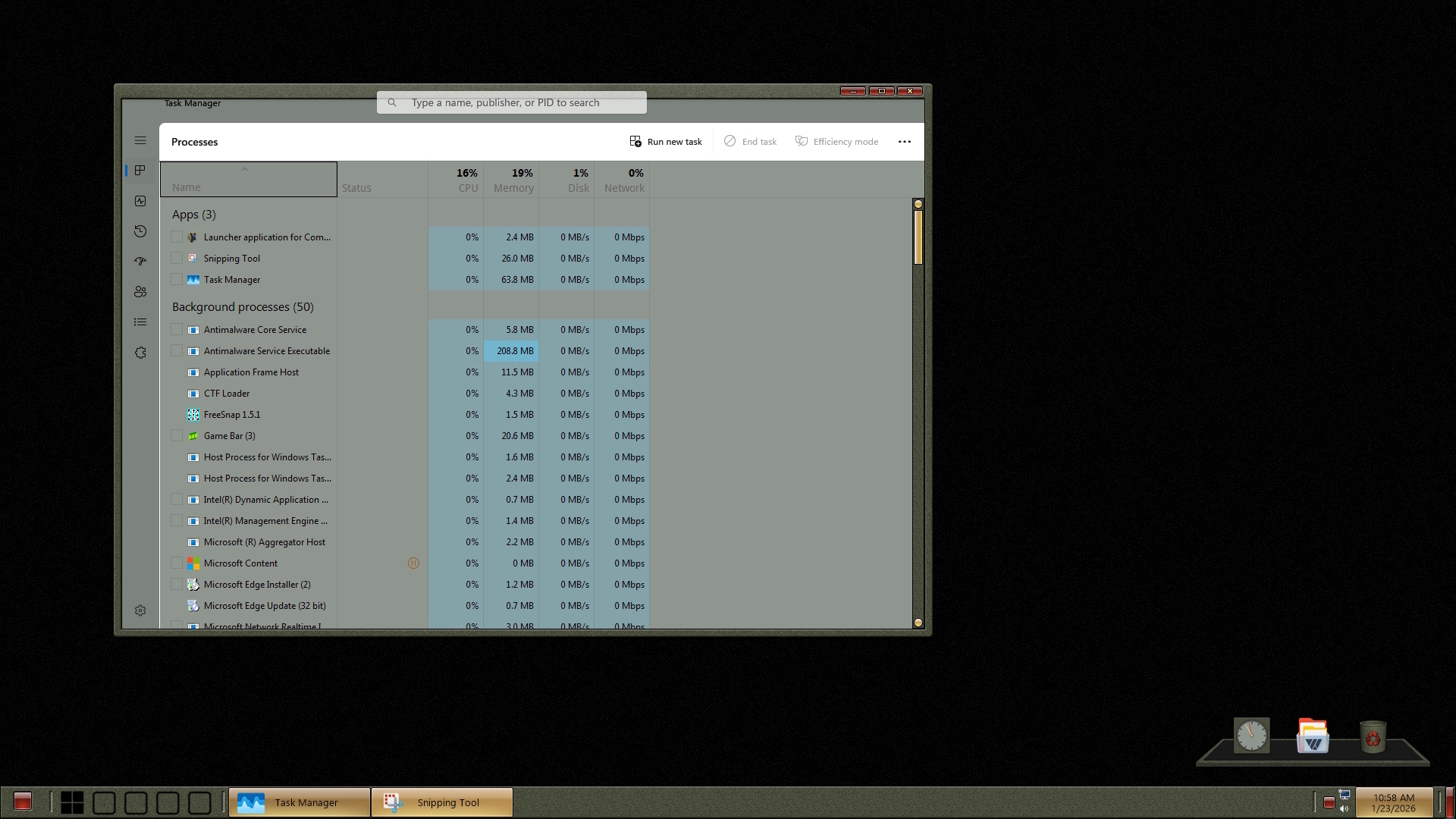

After installing the latest beta, when I run the launcher for Command & Conquer The First Decade, the launcher window does not show on the screen and it doesn't show that it is running on the tasklist . The Task Manager and Foretester both show that it is running though.
This happened on Windows 10 and Windows 11. Both are the latest versions.
I was also running Start11, Windowblinds 11, and ExplorerPatcher. I uninstalled ExplorerPatcher, Start11, and Windowblinds 11 and the problem still occured.
If I run the laucher from a desktop shortcut it works just fine.

PostPosted: Fri Jan 23, 2026 5:42 pm
Posts: 111

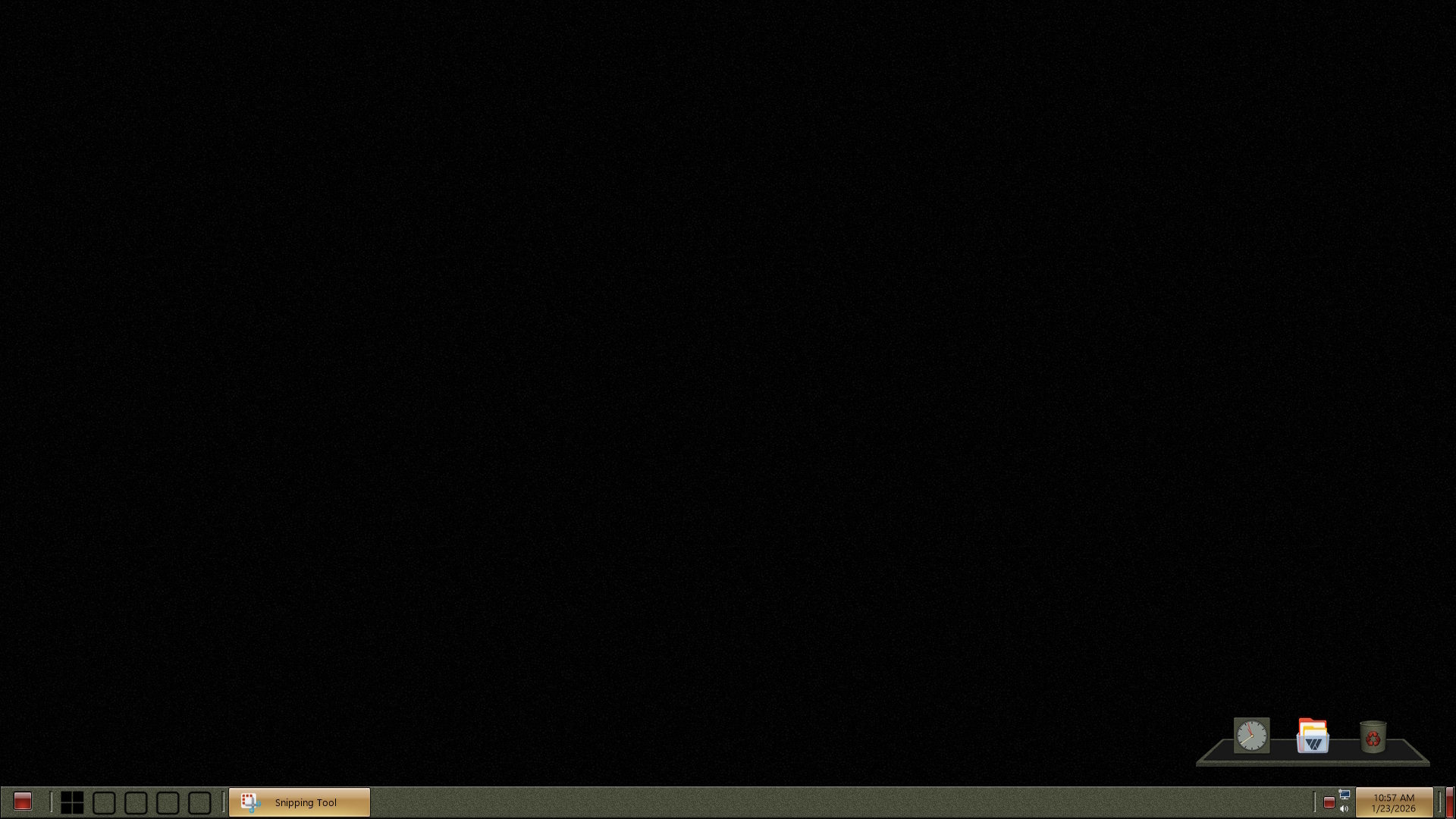

I could not add a screenshot showing the launcher working on the previous beta on my last post. Here it is.
I also forgot to add that I tried starting the laucher from a Grid Stack and from a Shelf. It did not work from either one.
After further testing I found that if I add the desktop shortcut that I created for the TFD Launcher to a Grid Stack it works ok.
If I try to start the launcher from the original Grid Stack entry, the launcher window does not show on the screen, but when I move the mouse over the area where the launcher window should be, the mouse pointer flickers when I move it.

PostPosted: Fri Jan 23, 2026 6:45 pm
Posts: 13126
Can you please post a screenshot of the ***Winstep**** Item Properties dialog for the item that does not work and for the item that does work? Would like to see the difference.
