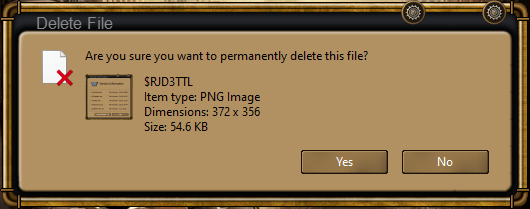

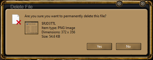

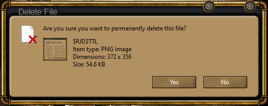

Winstep wrote:
I don't get the <$filename> issue in the confirmation dialog they mention either.
I noticed that right away after patch Tuesday, but didn't pay any attention to it. I think that is the original issue people were posting about. I deleted a file named "Version". When I emptied the Recycle Bin the dialog listed the file name as $RJD3TTL.
The latest beta works perfectly on Windows 10. :D I'll give it a try tomorrow on Windows 11. I don't expect any problems, but if I do I'll let you know.
Thanks for all of you hard work, and on a weekend no less.

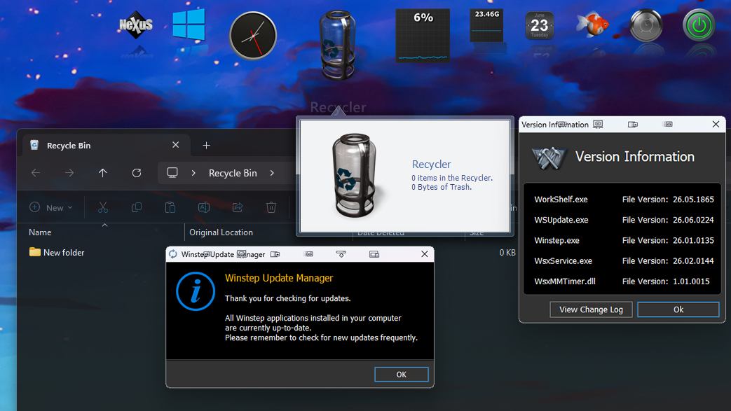

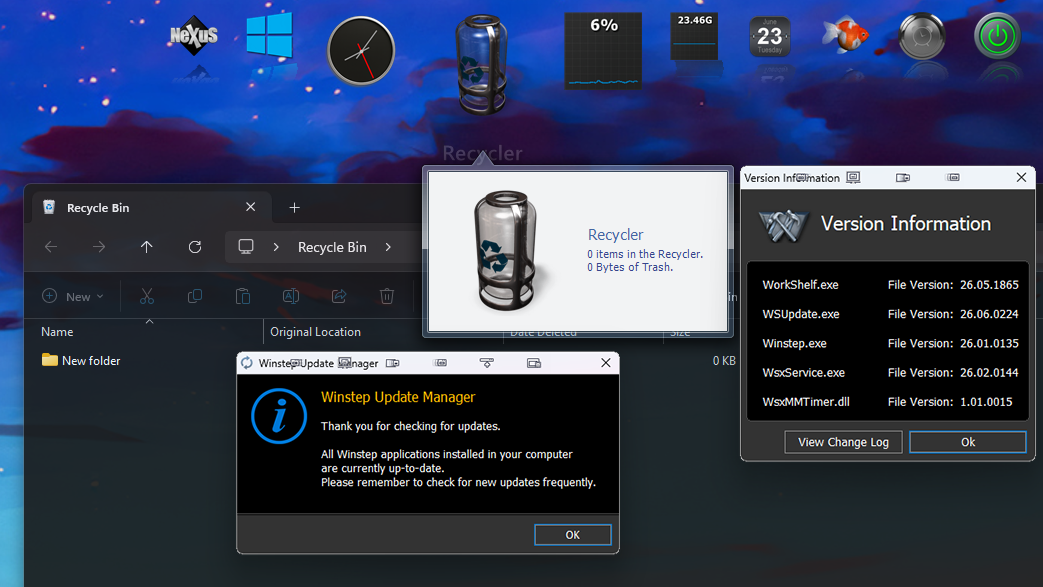

Posts: 60
Thank you so much for your empathy and condolences during these unexpected events I'm going through, but that's life, we have to face it and keep going.
Thanks again...
With the latest beta, under Windows 11, the Winstep Recycle Bin module seems to work better. When I delete something, it immediately displays the number of files deleted along with the balloon tooltip.
However, if I add a few files, it doesn't update. But if I open the contents of the Windows Recycle Bin, it immediately updates and adds the additional deleted files.
