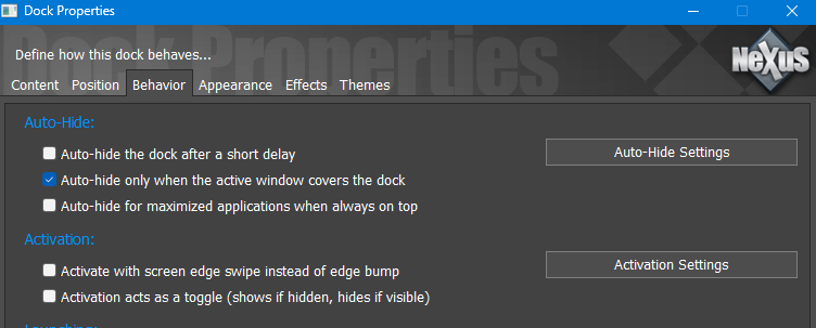

Also going to add this (window dodge, or auto-hide when covered by window):
 Post subject: Re: So, what's next after v26.4 ?
PostPosted: Wed May 20, 2026 7:34 am
Posts: 13118
And done! Actually works better than I expected. :D
"Auto-hide the dock after a short delay" and "Auto-hide when the active window covers the dock" are, of course, mutually exclusive settings. Selecting one unselects the other.
Still not sure what to do with the "Enable/Disable Auto-Hide" in the dock's main context menu though. These are essentially two different "modes" of auto-hide, so the current "Enable/Disable Auto Hide" menu option might turn into a "Auto-Hide" sub-menu with "Never / After a short delay / when a window covers the dock"

Besides adding PWA support to Brave browsers, this one adds the new "Auto hide when active window covers the dock" setting.
Not bad, but personally I would be driven crazy by the constant hide/collapse and show/expand sounds lol. Fortunately you can turn those off or set them to nothing.
