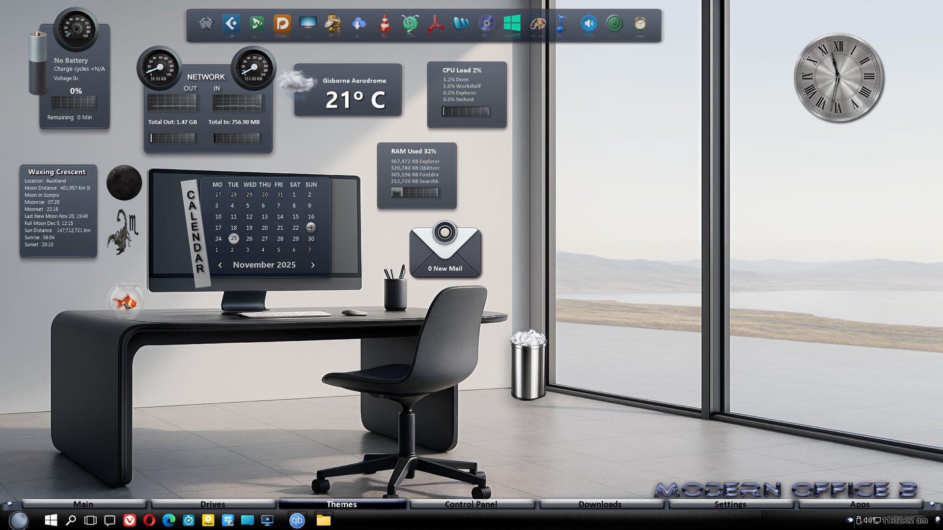

Ok finished this one.
Nothing spectacular, but it is clean and fast and it has working battery information that will work on both Laptop batteries and UPS'. I also worked out what I was doing wrong with the multi's in the battery. The Net is fully in sync with all meters.
I won't do that again in a hurry, it was not as easy as it may look. I've also aligned the battery grid and multi better since this image. Additionally, I've changed the text in the Moon Phase to white as the grey rasterization is not pretty. Also, customised the Zodiac signs I created a while back to 'almost' greyscale for this theme only. :)
I'll upload it to the gallery soon but it will be in zip format.
I'm afraid the perspective is all wrong where the modules are concerned - they look as though they're suspended in mid-air at an angle to the glass panes. And the recycler/waste bin lacks a shadow - all the furniture has one. Just thought I'd point out the obvious, trying to help. Sorry.
As always your feedback is appreciated. Nothing to be sorry about. :D
There is next to nothing inaccurate about your feedback. I could theoretically angle the module placeholders 8-10 degrees to the right, or remove the view completely from the window panes so the suspension aspect if I felt it important would be completely unnoticeable. Honestly, if I did that while it would be geometrically accurate, I believe it would feel more uncomfortable than you suggest it is? Some of the modules could be moved to far left on the wall so it would be unnoticeable and if I moved the Calendar to the far right the angles would be more noticeable.
The 'next to nothing' being the trashcan actually does have some shadow, just not as much (2 pixels), but in terms of making it look more like it is part of the floor scene which an educated guess thinks that this is what you mean, I could look at doing a larger 45 degree shadow that is on the left, save it, then hone in on only the left shadow and make it around 50-65% transparent.
I appreciate your perfectionism, it's a credit to you.
EDIT:

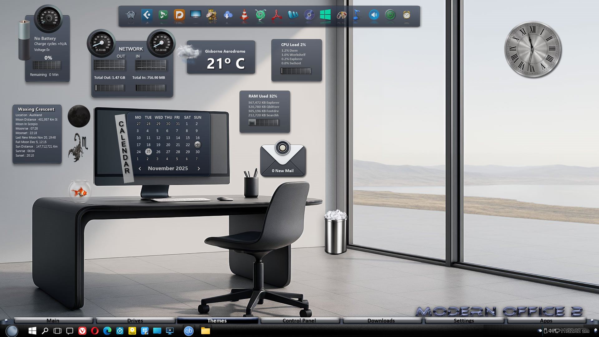

I did what I mentioned I could and moved to the left as you can see. It is after all, modular. I did make enough space to do this in the design :)
I additionally played quickly with the shadow and as you can see it still doesn't look like the others but in fairness to myself, I never intended it to be, though it does look like it sort of belongs better. If I wished to be more critical, the Monitor angle needs to be adjusted too, it's also marginally wrong geometrically by around 12 degrees.
It works though and I can actually live with being less perfect for once. ;) If I mess with angles too much, I can knowing myself, get annoyed with myself because I can easily mess the entire theme up without much effort :lol: . I can already see without changing anything, that if I corrected the monitor to match the module angles it would look incorrect against the table. If I corrected the modules which is feasible, I'd need to enlarge the canvases of each one because more than likely, I'd have to redo the information absolute placements.

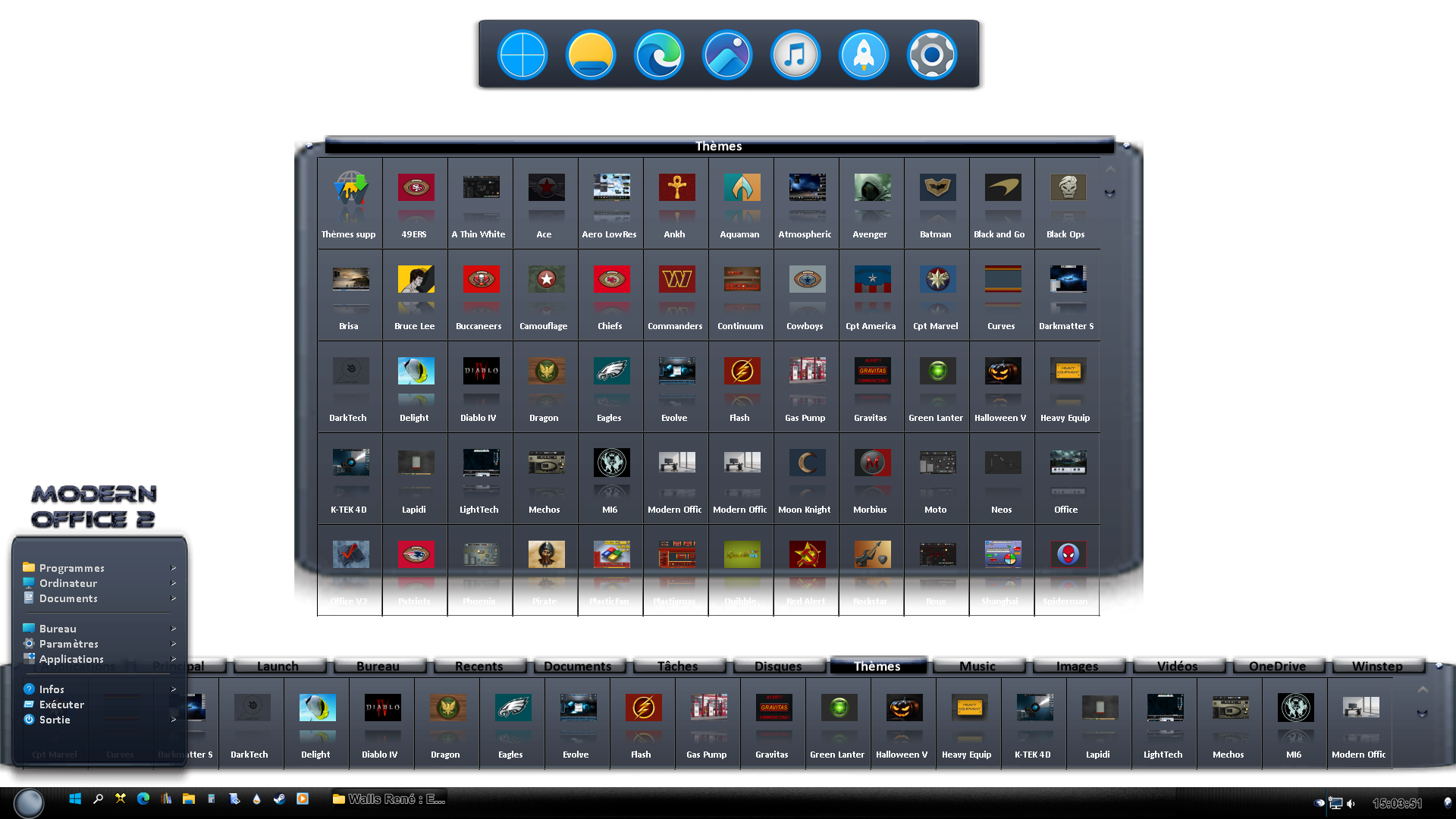

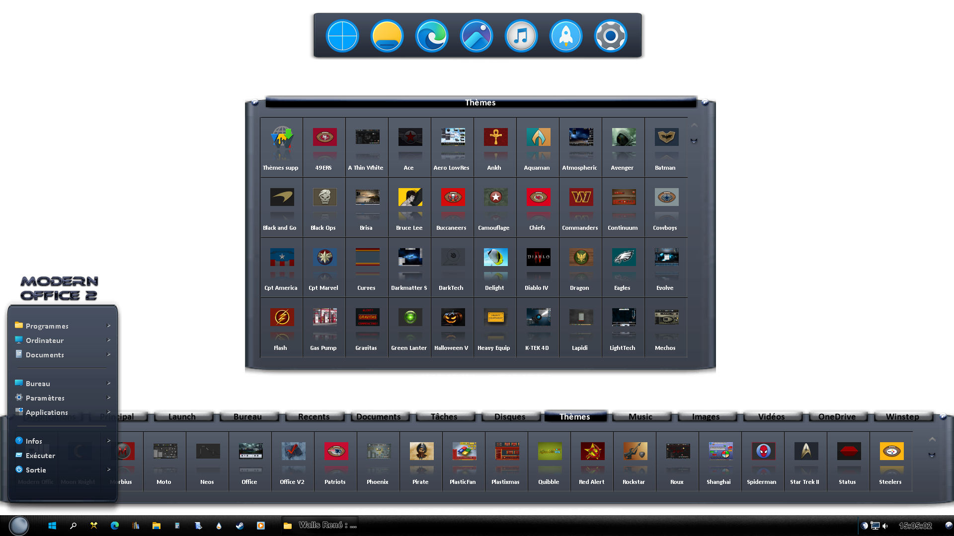

However, several things bother me, and without meaning to be presumptuous, I'd like to discuss them with you, particularly regarding the values ​​you insert into the .wst and .wsw files for the taskbar, menu, tablet, and grid stack.
For example, with the "Modern Office 2" theme, I had to reconfigure these two files to make the theme consistent while keeping the bitmaps you created with virtually no modifications, apart from three or four.
The menu:
For me, this is the starting point for building a theme.
You created a 240 x 399 pixel menu. You split it into 3 parts: Title 240 x 85, Button 240 x 236, and Endcap 240 x 78. Why are you changing the values ​​in the .wst file? If you want your menu to be identical and not distorted on output, use the same values:
TitleVSize=85
ButtonMaxWidth=240
ButtonMinWidth=240
EndcapVSize=78
EndcapHzSize=240
TitleHMenuSize=240
Furthermore, you've decided to make the ButtonAS and ButtonIS buttons 29 pixels wide, OK, but why make them 313 pixels wide? No, they should be 240 pixels wide, the same width as your menu. The same goes for your spacer, which should be 240 x 29 pixels, not 416 x 10.
The Taskbar:
You've created Start buttons with a width of 42 pixels. Make the taskbar 42 pixels wide, not 50. The same applies to Tasks, SysBack, BarSep, and Quiks; all should be 42 pixels wide. :
nTaskbarLeftTile=10
nTaskbarRightTile=10
nTaskbarButtonWidth=61
nTaskbarButtonHeight=42
nTaskbarALeftTile=10
nTaskbarARightTile=10
nTaskbarMLeftTile=10
nTaskbarMRightTile=10
For the Starts tiles, the correct values ​​are 65 x 42.
The tablet:
This is more complicated because the tablet's structure will also be used for the grid stack.
You created a wsFullBody tile of 1600 x 194. I resized it to 1920 x 189 without modifying it, just lengthening it and removing 5 pixels from the bottom. The goal is for it to display with the same height of 189 pixels when the theme is launched. So, I take screenshots, open them with GIMP, measure the height in pixels of the full body, and then increase or decrease the values ​​in the .wsw file as needed for each screenshot to achieve a height of 189 pixels and center the grid. It's tedious, but that's how I do it.
For the various buttons: Hide, Show, Prefs, and others, Winstep is programmed to render them in 16x16 pixels. You created them in 65x42 pixels, so when rendered, they appear as oval 16x16 pixels. I changed them to 42x42 pixels to keep them round.
Regarding the modules, I have no issues; I have nothing special to report.
I also looked at the "Steampunk Air" theme. I don't understand it. Building a 1130 x 1738 menu and then shrinking it to a blurry mess by reducing its dimensions in the .wst file is heresy to me, but that's just my opinion, and I say it with all due respect.
I've outlined part of my theme development process, but it's only a part, and it remains my personal logic. Other methods exist and are perfectly valid; everyone has their own experience and vision.
One more thing:
Also, to compress a theme and install it with one click, don't compress a folder inside a zip archive.
To do this, open your theme, select all the theme's bitmaps, and compress them using WinRAR, 7-Zip, or another program with the .xtreme extension.
When you open your .xtreme file with WinRAR or another program, the theme's bitmaps should appear directly, not a folder containing the theme.
01-Your theme with a white background and icon reverberation:
02-Your theme with a white background after modifications:
I offer you my sincerest regards and please continue...

That's the best compromise, I think, and much more believable. It doesn't jump out at you screaming that this space can't possibly exist. :D Glad you figured a solution.

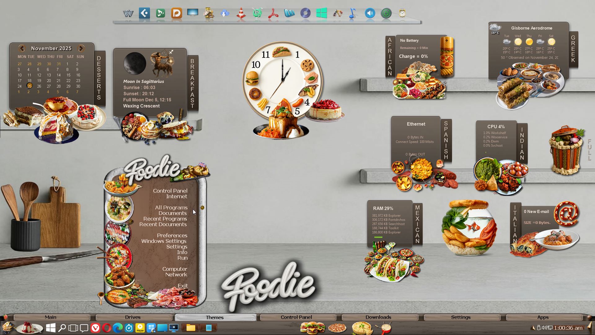

THEME:
I love food and there isn't much I do not like...so why not :) The only difficulty was I couldn't get every possible form of food in one theme. They are skinned themes with a limited amount of space and limited number of modules, not a book or a thesis.
Merry Christmas people.

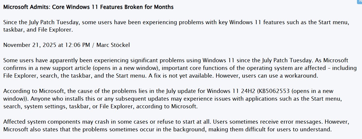

While I certainly appreciate useful feedback and better ways to be productive, I have to admit that Jorge and I have been going to and fro and whether it is me, Winstep, MS or GPU's causing me to pull my hair out over things that never seemed to before doing weird things on scaling and adjustments that made no sense and definitely made no sense with menus and scaling. I felt like I was stupid for a little while and I certainly am not.
TODAY - I found on a forum complete with a link on that forum to Microsoft's admission, that my frustration had nothing to do with Jorge or me.
Look it up. The bad news? It's not like they're going to release the fix for it immediately. Go to MS and look up for yourselves. I'd be sarcastic, but honestly since MS's fixes have really not improved that much e.g. "DOS 6 will be fixed in 6.1, will be fixed in 6.2, will be fixed in 6.22..." = Nothing has really changed... Well I suppose they can say that they are consistent...Later...
(NOTE - the problem was the July patch and the Nov 21 patch of theirs exposed it)
From the forum (screenshot):
