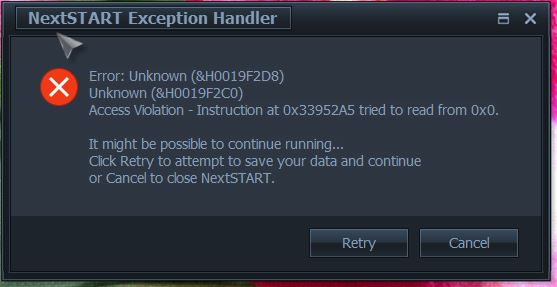

Keep getting this error in various situations (like playing with the colorisation methods or trying to replicate the bug on point 6. The address and hex values from the popup windows seem to always be the same, I can always recover by clicking retry.
I have no more time now to look through the rest of the posts. I`ll see what I can do later.
Hope this helps Jorge
I'll try reproducing here too.

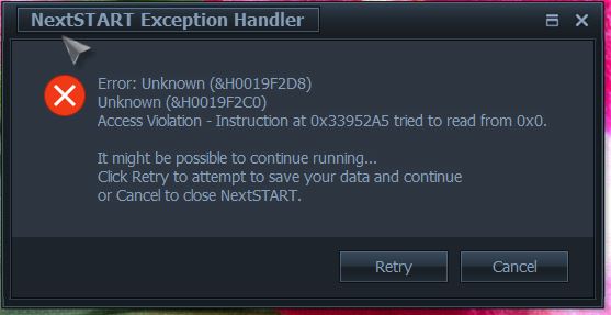

Vlad wrote:
Also if you change the colorisation option from Windows Accent color with shifting hues to Windows Accent color with tint, when you click apply hotspots get reset to a default, meaning you loose any custom hotspots and you get the default button to open the menu in the top left corner. If you click cancel, everything goes back. Otherwise you have to restore the settings from a backup to get things back.
This one is a biggie. Haven't tried reproducing here yet but I will in a minute.
I am back to my computer. It seems that after a shutdown and restart, those 2 problems do not ocur anymore. I will notify you if they will come back.
