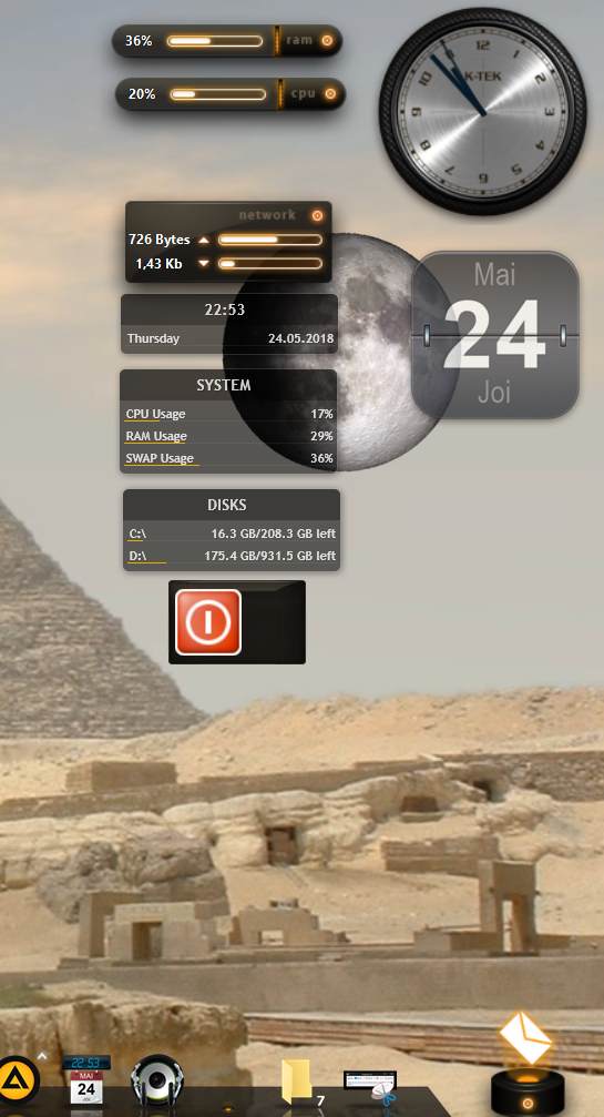

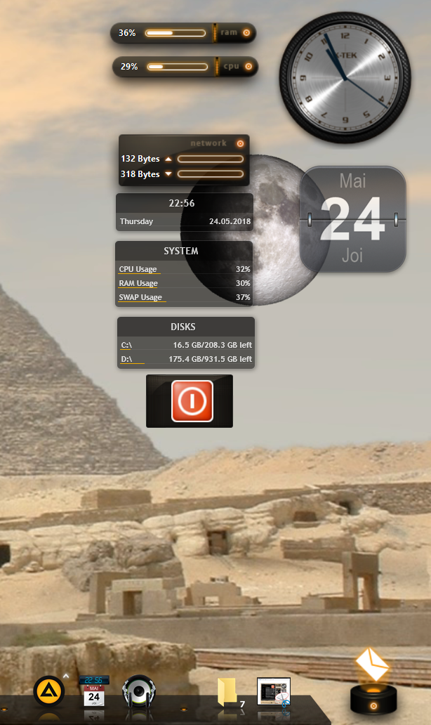

Posts: 159
Vlad, not sure I can fix this in time for the next beta, since I'm in a hurry and I need more info.
Is the shift you are talking about the same shift that happens when you click and hold the button? How about a screenshot? :)
here are the screenshots: the normal version and the shifted one
PostPosted: Thu May 24, 2018 8:25 pm
Posts: 13140
Wow. Now THAT is an hotspot button. lol
And yeah, nothing to do with the pressed position. Any idea what triggers that shift?

Posts: 159
Well, not big enough if your eyesight is that of a mole. Kidding, my eyesight is still good, only a beginning of Nearsightedness, but I still fight when it comes to wearing those pesky glasses....
Anyway, I have played with the settings and sizes of that button a lot, I have made it bigger for the screenshots.
As to what is causing that, my guess is that is related to some refresh actions. For example: now I have the Vivaldi browser window maximised, if I minimise that, the button will shift. Hard to say if only that is the cause of the problem. Currently I only have 1 monitor and thus forced to work with full screen windows most of the time and jump around virtual desktops and stuff... So I can not tell if others things are causing that also. One thing is certain: even if I keep the window maximised, jumping to another virtual desktop (just by win+ctrl+left/right arrows) it is enough to trigger the shift problem.
