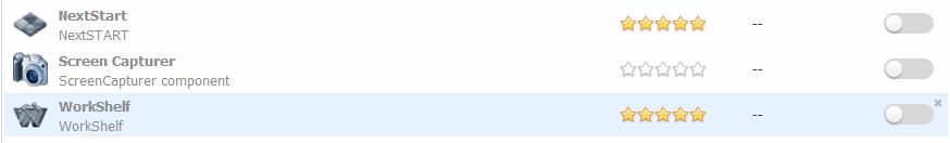

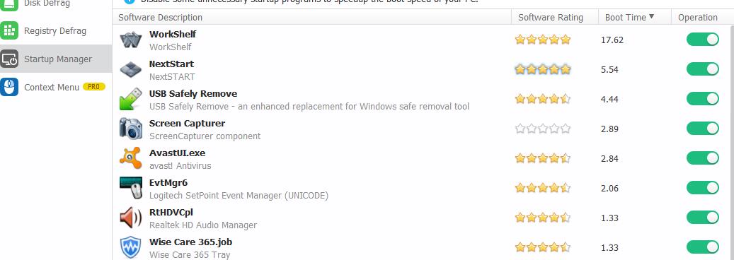

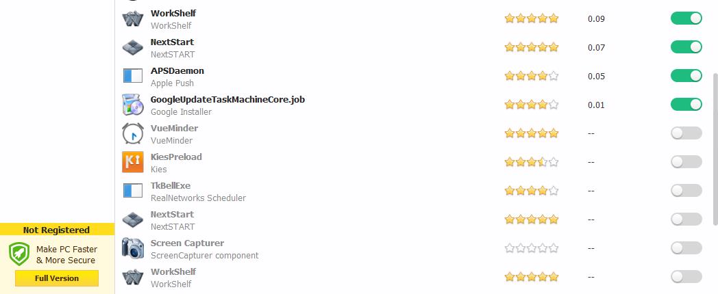

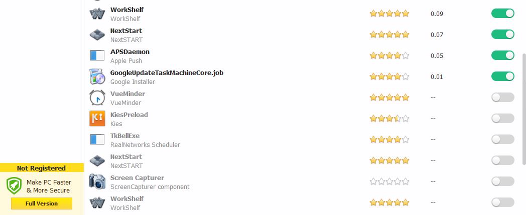

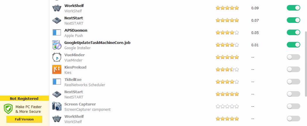

Okay, here's round two. I later tested it several times and unfortunately the boot times again increased to 190 seconds. The WorkShelf boot time was 25 seconds.
I then disabled WorkShelf via Wise Care 365 (which also disabled NextSTART) and restarted the PC. The boot time dropped to 89 seconds. As you will see in the following screenshot something really odd after I re-enabled it. It shows both WorkShelf and NextSTART enabled and disabled. :? Notice the boot time.
I restarted it again and the boot time was 92 seconds. Again you see how they are both enabled and disabled. This is consistent throughout.

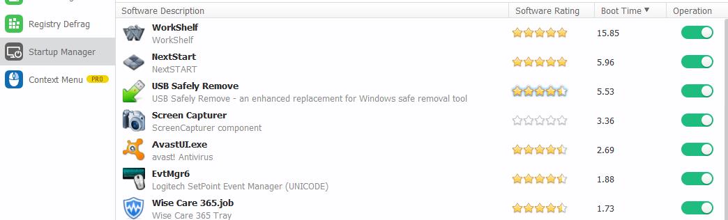

On the 3rd try I enabled Screen Capturer and the boot time increased to 104 seconds. I also disabled CCleaner Monitoring but it didn't disable.
I tried a 4th time. This time I disabled CCleaner Monitoring by using CCleaner and it worked. The boot time decreased to 90 seconds.
As you can see, there are several fluctuations in the boot times of WorkShelf. Except for the first screenshot, NextSTART is consistent.
