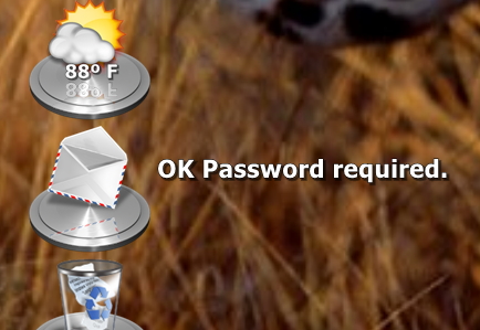

Well... I had it working for a while by having the Mail Checker bypass att.net and go directly to imap.mail.yahoo.com. It suddenly stopped working a couple weeks ago and now I think I know why. Since Verizon bought Yahoo the relationship between AT&T and Yahoo has changed.
I have reconfigured the Mail Checker go to inbound.att.net. That seems to be trying to work but I get a pop up message on the icon. It says "OK Password Required". Mail Checker has the correct password for the mail account. Any idea what that message means?

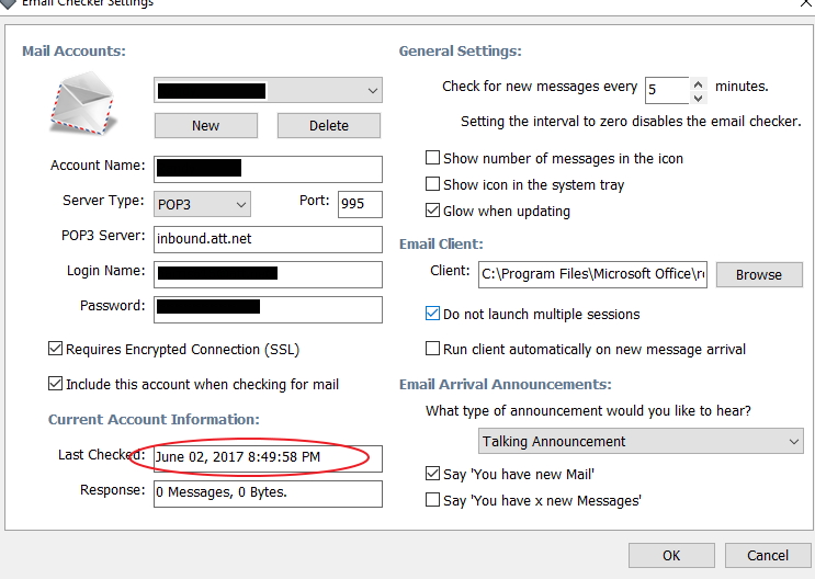

No, POP3. Please look at the attached picture of my settings.

Can you please post a picture of the pop up message on the icon saying "OK Password Required"?
 Post subject: Re: E-Mail Checker using SSL
PostPosted: Mon Aug 21, 2017 5:16 pm
Joined: Sun Feb 26, 2012 3:09 pm
Posts: 42
Picture attached.

PostPosted: Mon Aug 21, 2017 5:47 pm
Posts: 12840
Alright. Very old code, a bit of a pain to go through it again.
Anyway, the problem is that AT&T are not using the standard POP3 protocol.
The server is supposed to respond with
+OK send PASS
See that '+' sign at the beginning? That's critical. Instead the AT&T server skips sending the '+' symbol and the Email Checker thus concludes that there has been some kind of an error.
Blame AT&T for thinking they're 'special' and don't have to follow the rules. Anyway, I'll see what I can do.
