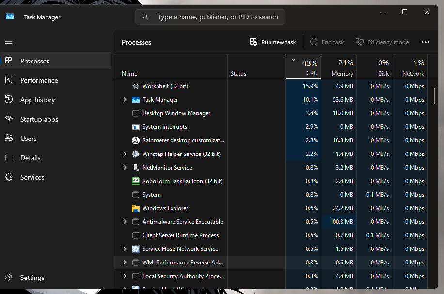

Closing and reopening has no effect for me. It continues to run high all the time for me.

I'm assuming workshelf is part of your Nexus install (I only have nexus ultimate which doesn't have the workshelf stuff).
But it doesn't seem to be using all that much, 15% isn't that bad depending on what CPU you use and how many cores you have. But the task manager shows your CPU usage at 43% but it's not coming from anything nexus related according to that screenshot.
But I do see you have rainmeter installed, which I do have a lot of experience with as I use it myself and I know that certain skins will use a lot of cpu power, which won't show in task manager as it runs in a different process that doesn't turn up for some reason.
Especially if you use one that has things like monitoring tools, weather stuff etc, those kinds of things constantly refresh every couple seconds which puts a load on the cpu.
So could be the combination of nexus running alongside rainmeter is what is causing the higher load.
You can try turning rainmeter off for a bit and just run with nexus and see if that eases up on things a bit.
Might be other things going on there too as it seems like you have a fair amount of things running in the background and starting with windows etc but I'd need a more complete view of the background task section in task manager to see if there's anything else specific that might be causing that for you. But rainmeter is more than likely the main culprit there as I've had that issue myself and actually stopped using most of the stuff I had set up in rainmeter because it was just constantly using resources even when it didn't really need to.
*edit* Now that I think about it, your system interrupts shouldn't even make the top 30 of CPU usage so I suspect there's something going on in the background there that is causing a higher than normal workshelf load
Although I do still think it's rainmeter because it shouldn't be using more than the occasional 1% so a nearly 3% load just from rainmeter itself is a bit abnormal and suggests you have a lot of skins activated or a few really demanding ones and that will use more CPU and cause the system interrupts to be higher, which depending on how workshelf works could be causing it to use a higher than normal amount of CPU to constantly update itself due to the rainmeter stuff changing etc.

It's an issue with 24H2. Ran under all the previous win 11 builds without an issue. As you, I have used rainmeter for an eternity, and it's not that. In fact I booted with just Microsoft services and workshelf enabled, and it was running between 10-17%. It's not massive, but compared to 23H2 which was like 2%. Revert for now back to 23H2, and maybe clean install later.
