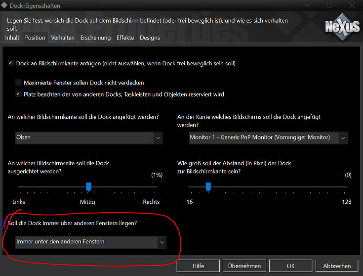

Yikes, more settings? Wouldn't that be complicated to do?
The Setting already exists. Only it does not work.
"Should the dock always be above the other windows?" My Setting: "Always under the other windows"
After all, that means the dock should always be under the maximized windows, right?
The problem with that is that you are then COMPLETELY unable to activate the dock when a window is maximized EVEN IF YOU WANT TO. You will ALWAYS need to restore or minimize that window first, as well as any other windows that might be behind it hiding the dock.
Besides, your problem is NOT whether you should be able to activate the dock when a window is maximized or not. Your REAL problem, the thing you are really trying to prevent, is accidental dock activations.
