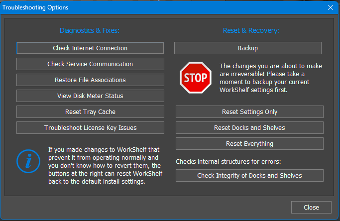

In the mean time, re-organized the troubleshooting dialog as I needed to fit a new "View Disk Meter Status" button to troubleshoot any issues with SMART data retrieval.

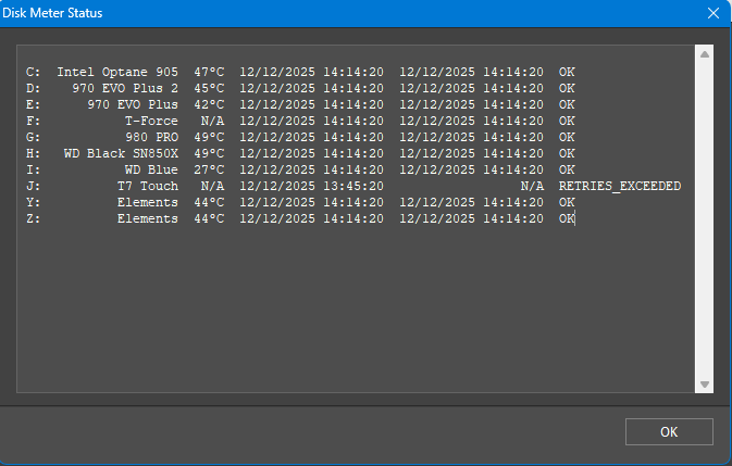

As I mentioned in a previous post, had the temperatures of two drives get "stuck" so I added some diagnostics information to the service and this dialog will help find out why:

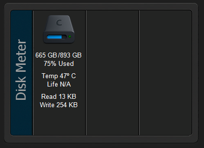

It's beginning to look like "something" :D
That does look good :D
And it did, and it's fixed. Actually very complicated stuff among other reasons because the code runs multi-threaded (the app part where the application requests info on some drives and then the actual data gathering part that is run on a timer).
The service continued polling SMART data even as the system was entering sleep or hibernate. At that point, the lower‑level API refused to respond and blocked until the system resumed - often many minutes later. Because the timer kept running, the service misinterpreted this as the drive taking longer than 10 minutes to respond, which triggered the “do not query again” flag.
Before applying that flag, the service now checks whether the delay was actually due to the system being in a low‑power state. If so, the delay is ignored, rather than ignoring the drive from then on.
