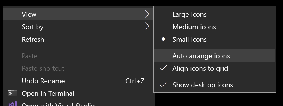

Make sure "auto arrange" is not set for the desktop icons.
You many also need to disable align icons to grid setting.
You can check these by right-mouse-button clicking on the desktop and select "view" from the pop-up menu. (See illustration attached)
This is a common and well known windows problem going back at least to the days of Windows XP.
Rather than typing all the steps in the process of elimination for troubleshooting this issue, here is a link to an article.
https://www.thewindowsclub.com/desktop- ... ter-reboot
Please respond back with the outcome for other users and so we can review if these steps did not resolve your problem.
