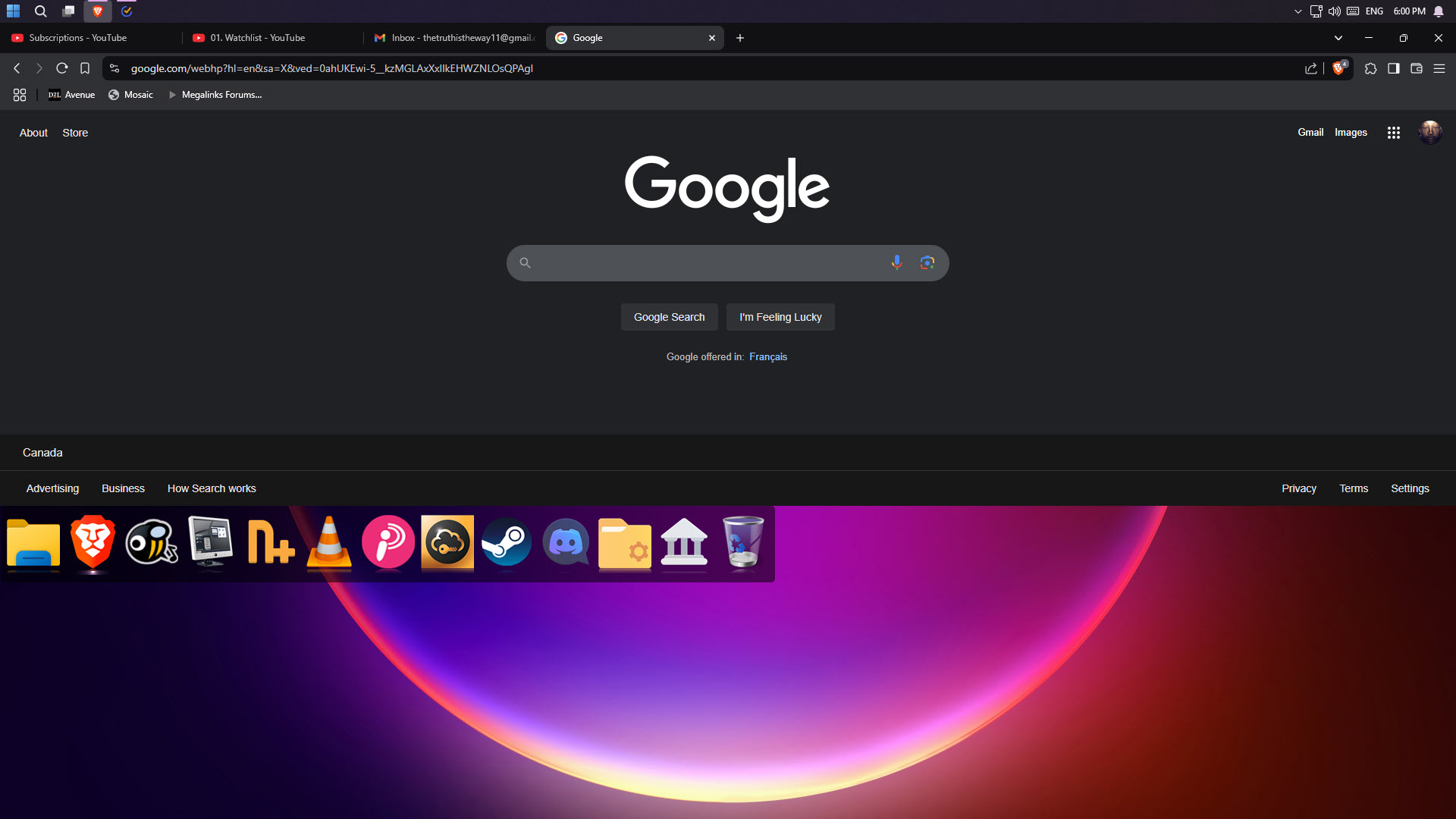

Can you please post a picture of your entire desktop when the dock moves to the center? Might give me a clue.

Here you go (hopefully that attaches properly). As you can see, when there is a window open in full screen, it resizes the window when it moves the dock over.
And yes, Nexus-Ultimate.exe is still running on the Details tab of Windows Task Manager when the dock disappears.

Ok, that seems very similar to what is happening with Start11. Since you say that it only started happening with the latest Windows update and not before, I am now more inclined to think this might be yet another issue with a Windows update affecting 3rd party applications (such as Start11, StartAllBack and Winstep) that reserve screen space so maximized windows do not overlap the docks, taskbars, etc...
As another example of a Windows Update breaking something else, a Winstep user contacted me a couple of days ago stating that clicking any of the Browse for files or folders buttons inside the Winstep application did nothing (vs opening the standard browser dialog). Upon further investigation turns out that he was also using WindowBlinds and that setting the WB skin to Windows 11 fixed the issue.
A quick post on Wincustomize replied to by Neil (WB's developer himself) revealed that what at first looked like a bug in the Winstep application and later a bug in WindowBlinds, was actually yet another issue introduced by one of the latest Windows updates. The next release of WB worked "fixed" this problem.
Anyway, I'm getting v25.2 ready for release, and one of the things it does different from v24.4 is resetting reserved screen areas upon returning from sleep. This will hopefully also stop that issue from happening there. Stay tuned.
