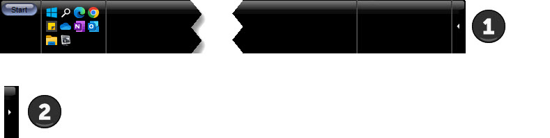

I still have the problem (I'm the original poster) but I just minimize the taskbar with the vertical bar on the right (I believe that's an option) then restore it. Two clicks.
It happens when the computer reboots or goes into sleep mode, or comes out of a game or when I use this little gadget to switch the monitor to my laptop and back.
The button doesn't work on a vertical taskbar. The taskbar just hides itself.

It does work if I click on it, but is there a way to make the "Reset Reserved Screen Space' internal command automatically run after a reboot or even after a change/refresh of monitor?
 Post subject: Re: Taskbar goes blank
PostPosted: Tue Sep 10, 2024 2:18 pm
Posts: 13118
Nope, sorry.
