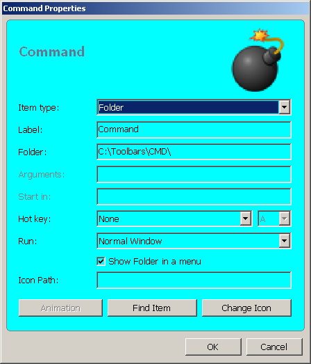

Can you please post a screenshot of the Dock Item Properties dialog for that PowerShell item in your dock?

Yes, it is via a shortcut. I don't know any other way to change colour ect. on the prompt.
I tried to uncheck "Do not launch multiple sessions of the same application"
and it makes no diff.
Here are some screenshots, and beware, one of them is in Danish:

Hanna wrote:
Ok, hold on, you are running those applications from a 'show folder' type of menu? See how details are VERY important?
Now I need to look at the code again lol
