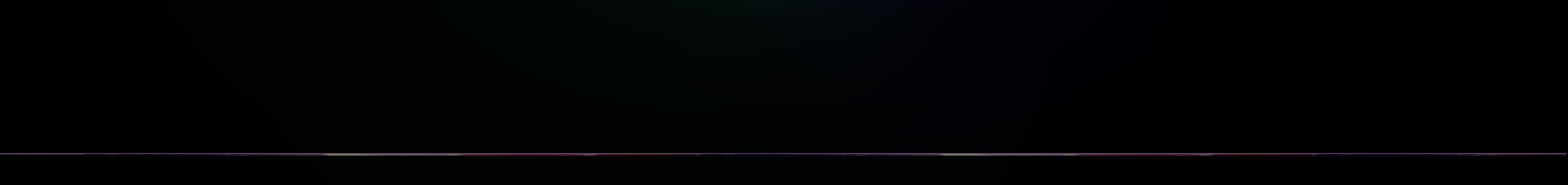

In the image below you can see the thin outline of the Taskbar hidden just above the hidden Windows 11 Taskbar

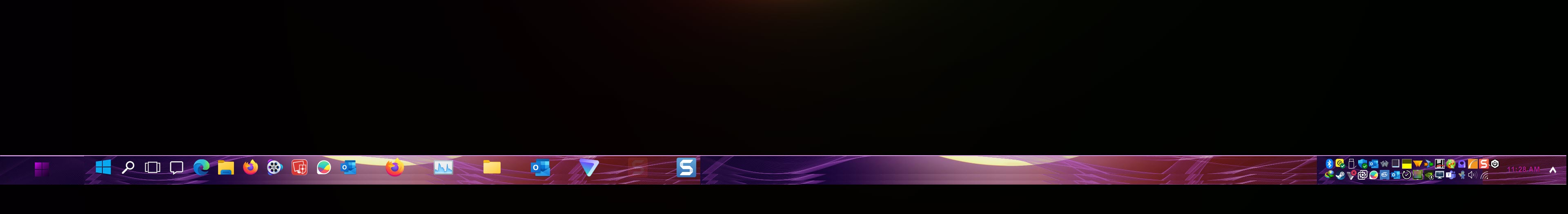

In the image below the Taskbar is exposed but sits on top of Windows 11 Taskbar. I did not have this problem with Windows 10 it sat at the bottom of the screen over the Windows 10 Taskbar. I want the Taskbar to sit on exact bottom of screen over Windows 11 Taskbar just like it did in Windows 10 and then hide into the bottom of screen.
If I leave the Taskbar undocked it will display correctly at the bottom of the screen but it hides to the bottom left of the screen and I can't find a way to correct it.

Yes, in Windows 11 Microsoft decided to tweak with the Windows taskbar, the systray and the mechanism used to reserve screen space. None of this tweaking was for the better, if you ask me, and the taskbar actually lost a TON of functionality.
Anyway, you have the NextSTART taskbar set to auto-hide, right? Mine is never set to auto-hide (in fact the shelf sits on top of it, as by the default configuration) but just the other day I was fixing an issue with the Windows Widgets panel closing as soon as the NextSTART taskbar hid and I noticed this issue.
I still have to look at what *exactly* is causing this different behavior, but it should be fixed in the next release, hopefully.
