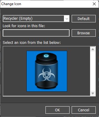

succede una strana cosa in questa icona.
ho cambiato l'immagine di winstep in quella classica ma il cestino pieno continua a visualizzare l'immagine di winstap originale ,mentre dopo la pulizia viene fuori l'immagine del cestino classico vuoto in modo corretto.
inoltre se tento di cambiare l'immagine di winstep originale a cestino pieno non viene modificata e rimane quella di winstep.
spero di essermi spiegato :D
ADMIN EDIT:
GOOGLE TRANSLATION FROM ITALIAN
a strange thing happens in this icon.
I changed the winstep image to the classic one but the full bin still displays the original winstap image, while after cleaning the empty classic bin image comes out correctly.
moreover, if I try to change the original winstep image when the basket is full it is not modified and the winstep image remains.
I hope I have explained: D

The Recycle Bin module has TWO images you can customize, one for each state: empty and full.
My guess is that you are only changing the image for ONE of the states.
At the top of the 'Change Icon' dialog for the Recycle Bin, you need to switch from 'Recycler (Empty)' to 'Recycler (Full)' and vice-versa.

i repeat that the problem appear only with recycle bin full, in this condition is impossible change the icon.
i dont know if is a specific procedure to do but that's element dont work
