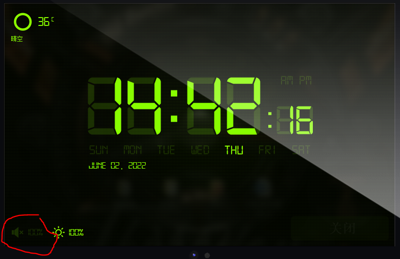

As shown in the picture, I thought of a lot of ways to always open the sound of the alarm clock.

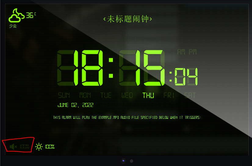

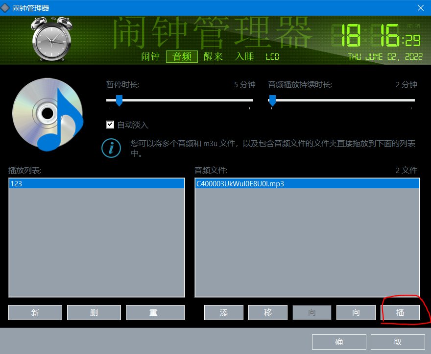

I did it your way, but it still didn't solve the problem, that is, the alarm still didn't sound, and I found that everything about the audio didn't play.
As shown in the figure:

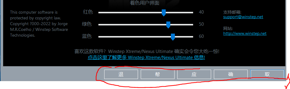

Something else regarding what I mentioned above about the Chinese characters, if you open Preferences and look at the buttons at the bottom, are Chinese characters being "eaten" whenever you have a UI mode other than 'Standard Interface' ?
For instance, this is how it should appear:
Note specifically the Chinese text in the buttons:
But when another UI mode is selected, the Chinese characters seem to be "cropped", looking like this:
Does this also happen to you? I don't know how to read Chinese so I can't tell for sure, but it does seem so, no?

I clicked the "Test Voice" button and it has sound. The clock chime function is also intact.Now it seems that only MP3 audio playback is problematic. That is to say, clicking the "Play" button after importing mp3 audio has no effect.
The question about the Chinese characters you mentioned does exist. Only in the "Standard User Interface" text is normal, in other modes the text is like being cropped partially.

I installed the Nexus v22.5 beta and the text cropping issue was finally solved. I checked and found that most of them were resolved, only the prompt box text that popped up when I clicked on the "Check for Updates" button was cropped.

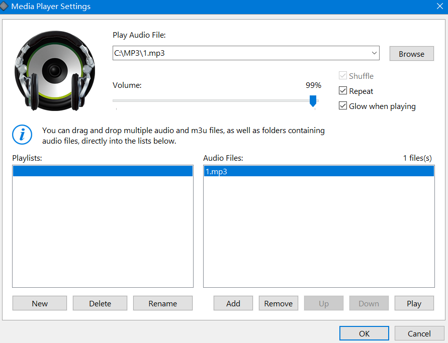

Add the Winstep Media Player to the dock by right clicking on the dock -> Insert New Dock Item -> Internal Command -> Media -> Media Player
Now right click on the Winstep Media Player icon and select Media Player Settings. Drag MP3 files to the panel at the right, play with the Media Player a bit. Can you get ANY of the MP3 files to play?

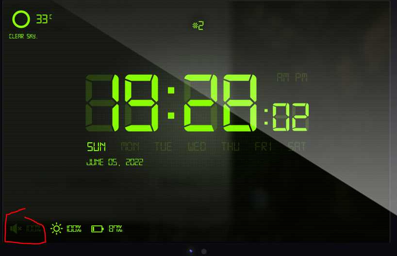

As for the mp3 audio, I was completely desperate, I tried it over and over again, but it didn't work out, it still wouldn't play, pressing the button didn't work in the slightest. And the volume icon for the alarm clock has been gray.
Just like in the pictures.
